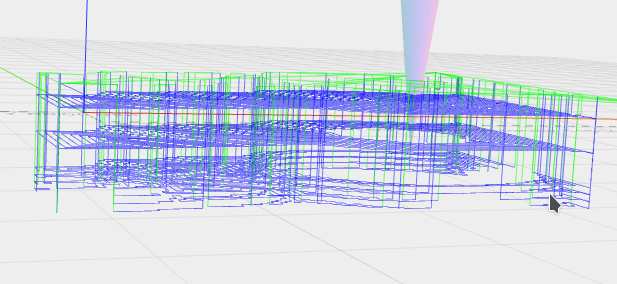

My bucket_mill.py project ( https://github.com/nathanielstenzel/bucket_mill ) seems to do okay with the toolpath. Unfortunately, the chuck on my router warmed up and decided to loosen up its grip on the bit. I did not notice that happened so a little bit later it snapped off and shot at the wall. I am lucky it did not fly at me. The bit cost $8-15. I forget the exact price. I imagine the bit would not have heated up as much if my chip size was bigger. Maybe I should have tightened it down even tighter too. I thought it was plenty tight.

@John_Bump , when it comes to chip size, does chip depth count? That is kind of independent of feed rate. I just made an adjustment to my code so that I can cut deeper each rough cut pass. I have heard plenty of times that bigger chips cool down the bit.
And yes, I just made another improvement to my project.
I just added a cut-depth parameter for rough cuts.
