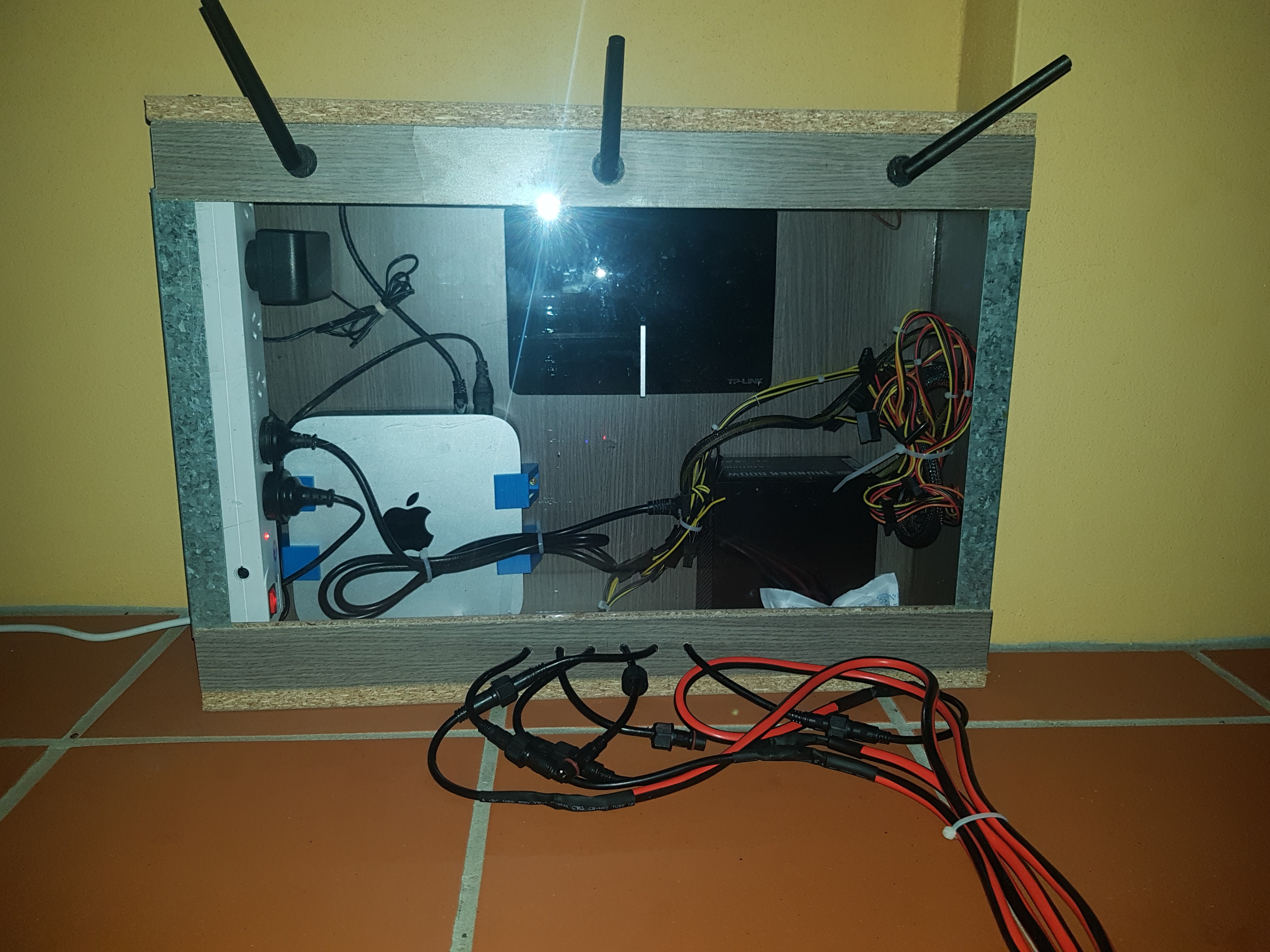

Sparkled is running on a Mac Mini. It provides a UDP server that ESP32 clients can request frame data from (e.g. a client might send “GF:P1”, meaning Get Frame data for Pillar 1). The server will check the progress of the current song and pull out the appropriate prerendered frame and send it to the client.

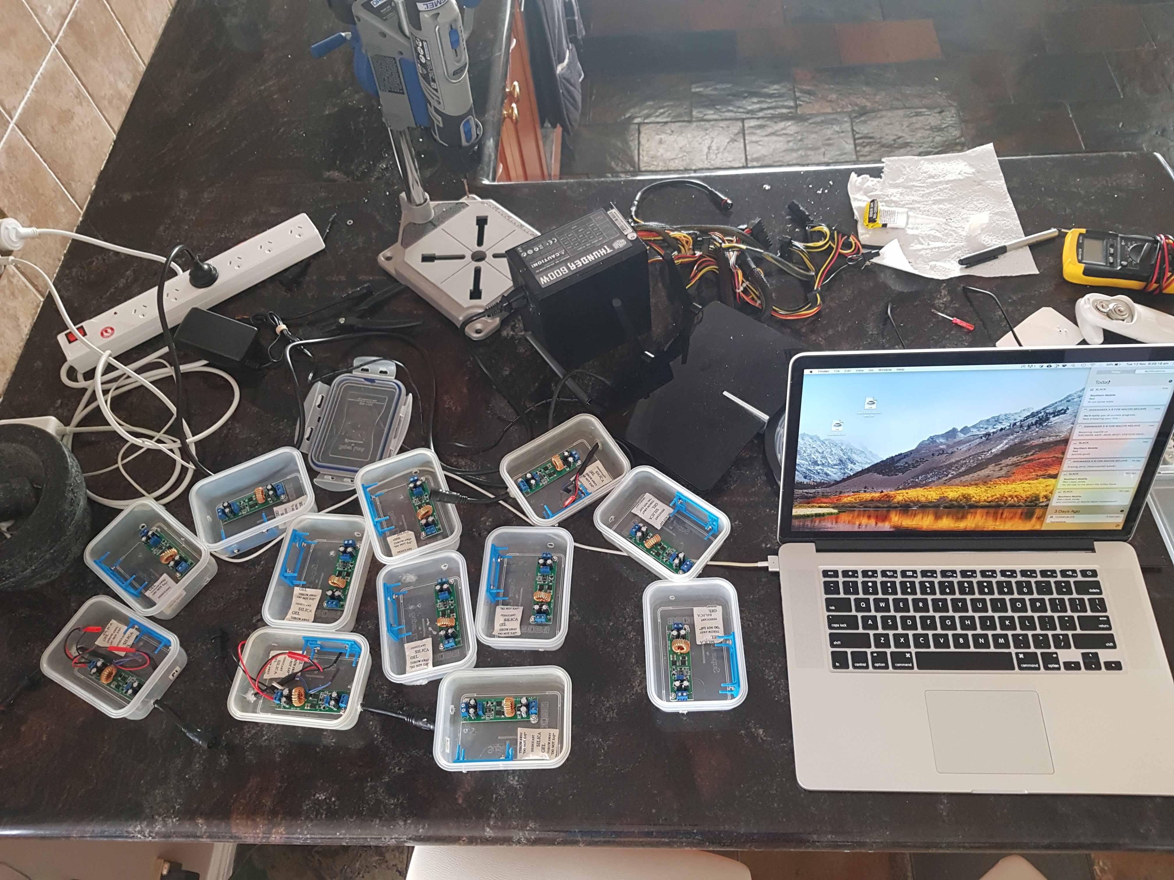

The ATX power supply sends 12V to the client controller boxes, which reduce to 5V with buck converters and they power an ESP32 and the strip itself.
There’s an attached photo show a box containing the Mac Mini, router and ATX power supply.
Let me know if you’d like any more info

The arches and pillars are powered by one power supply, and the lights on the roof are powered by another. That’s mainly for convenience.
