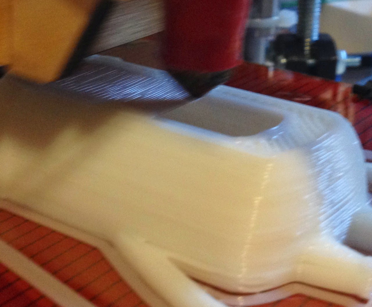

My cleanest bridge ever.
My cleanest bridge ever. So proud of myself I thought I should share it :slight_smile: Dialing in params for PLA I got from mixshop in Toronto.

Whats your temp and print speed with that PLA? Looks sweet!

Thanks! 200C for temp and printing at 50mm/s. However, bridge speed is slowed to: 50% of that) Also, you can’t see it in the picture, but there’s a 40mm fan blowing at my nozzle after the first layer is down. It also speeds up to 100% fan speed for the bridge!
