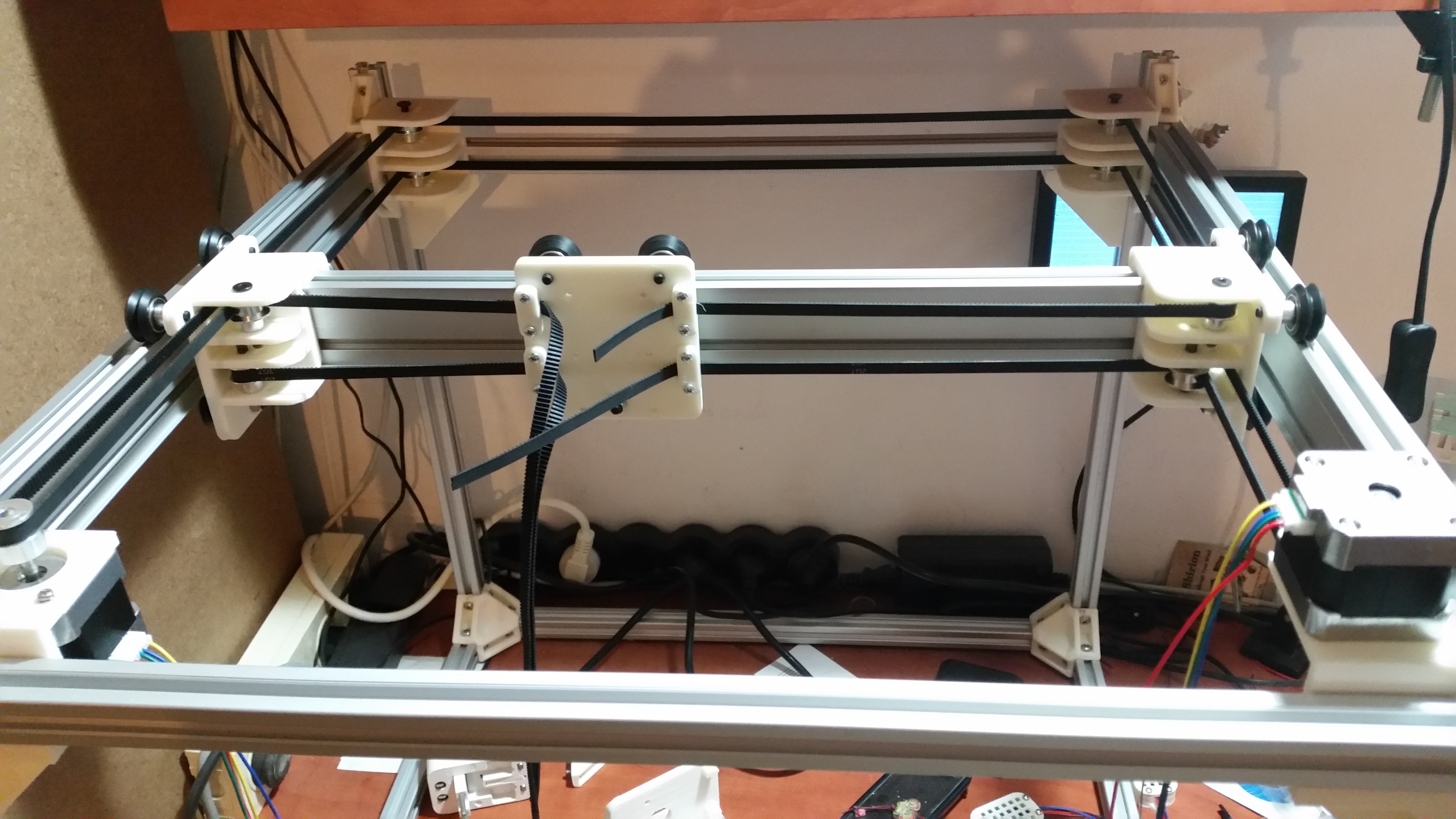

My corexy build. Makerslide and 2020, 500x500 frame. What do you think about design?

Are those printed corner brackets? You’re going to lose a lot of rigidity with plastic joints in a printer that size. I’d either put some metal corner joints in there or add cross-bracing to the frame.
@Ryan_Carlyle Thanks. I was inspired by models with only printed parts. Good idea to replace them, after the main mechanism will work.
@Mark_Rehorst Thanks. It seems like I forced to move the motors outside the frame. Tried to avoid it.
