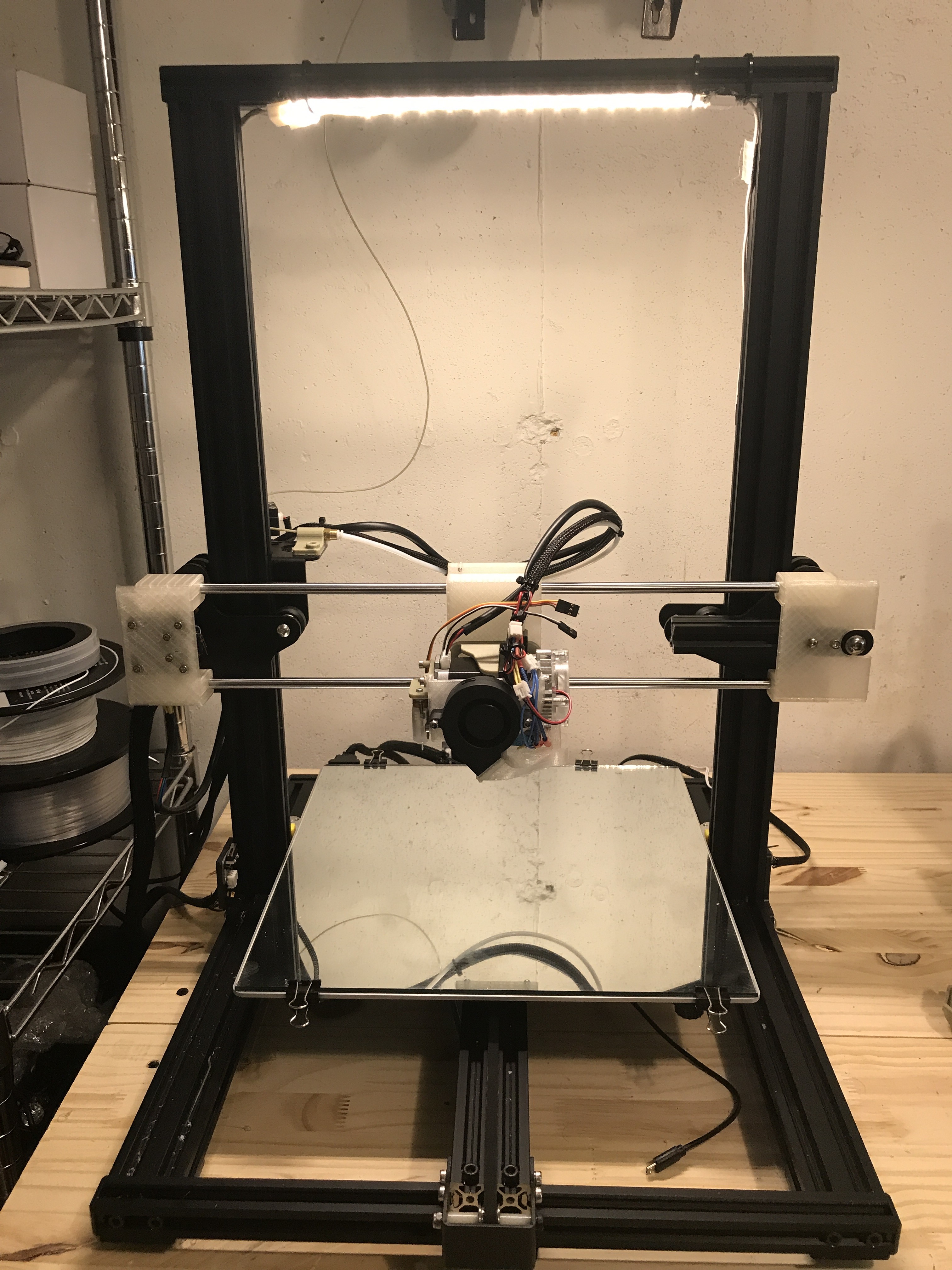

My “CR-10S” upgrades are about done.
My “CR-10S” upgrades are about done. At this point it basically isn’t a CR-10 so I am going to call it the CR-Titan. I’ve upgraded the extruder to the E3D Titan Aero and have gotten rid of the original X-axis gantry and created a steel rod and linear bearing carriage for the X-axis that should make it much smoother, quieter and more rigid. I modeled up all the parts for the custom build in Fusion 360 and printer with my other two printers while doing the upgrades. The old belt was too short so I ordered a new belt and still need to wire up the BLTouch and I am done.
Looks cool!
:+1::+1:
Very nice mod. Have any plans on sharing the x gantry mod? Maybe a video like your excellent bltouch installation video.
