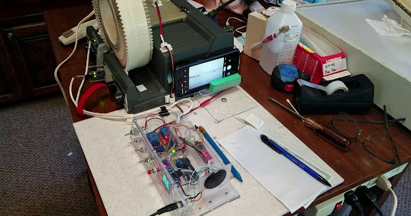

We built a controller using a nano and relays that controlled the projectors slide handling.

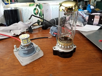

  • The incandescent bulb is replaced with a LED Brake Light array and a diffuser plate. The collumating lenses were left intact. A socket was fabricated that is a plug replacement for the incandescent bulb.
  • The final lens was removed and a phone is mounted at the output of the projector.
  • A controlled relay is connected to the projectors wired remote simulating pressing the advance button. The internal voltage of the projector is LV AC so we decided to isolate it.
  • The controller includes switches and buttons for the operator to set tray size and copy mode as well as an OLED display to show the copiers status.
  • A battery operated BT selfie shutter is used to command the phone to take a photo. A relay also connects the nano to the shutter by a simple hack across its switch contacts.

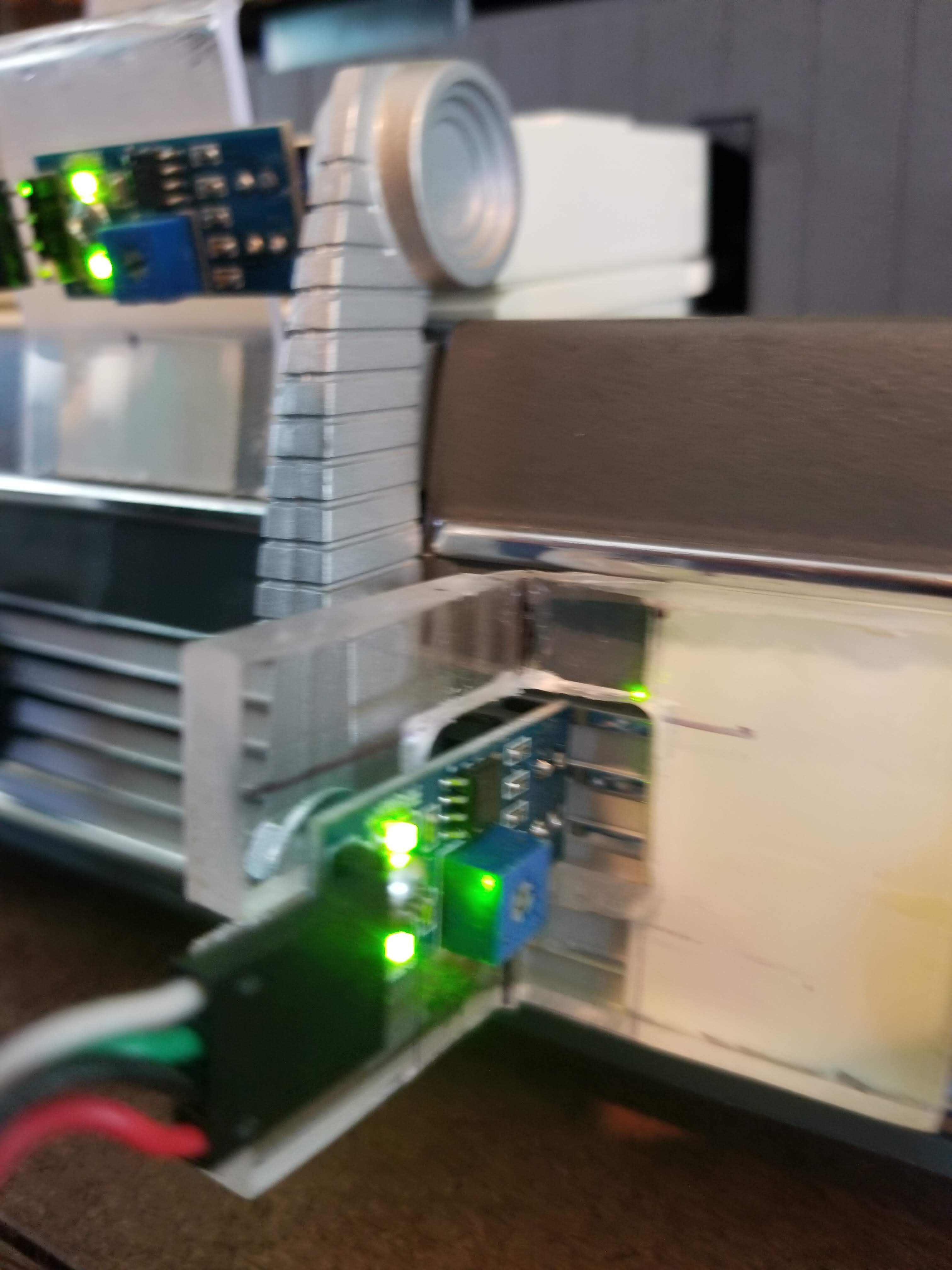

  • Two optical sensors were db taped to the side of the projector to detect tray presence and slide jams respectively.
  • The controller software uses a simple state machine and display driver to control wait, automated copy, manual copy and diagnostics. You can select tray size and modify the starting slide #. The software detects a missing tray and slide jams.
The copier will copy slides at a rate of 825.68 slides/hr so we can copy all our slides in less than 5 hrs. The projects material costs were <$50.

Tray and slide arm sensors:
