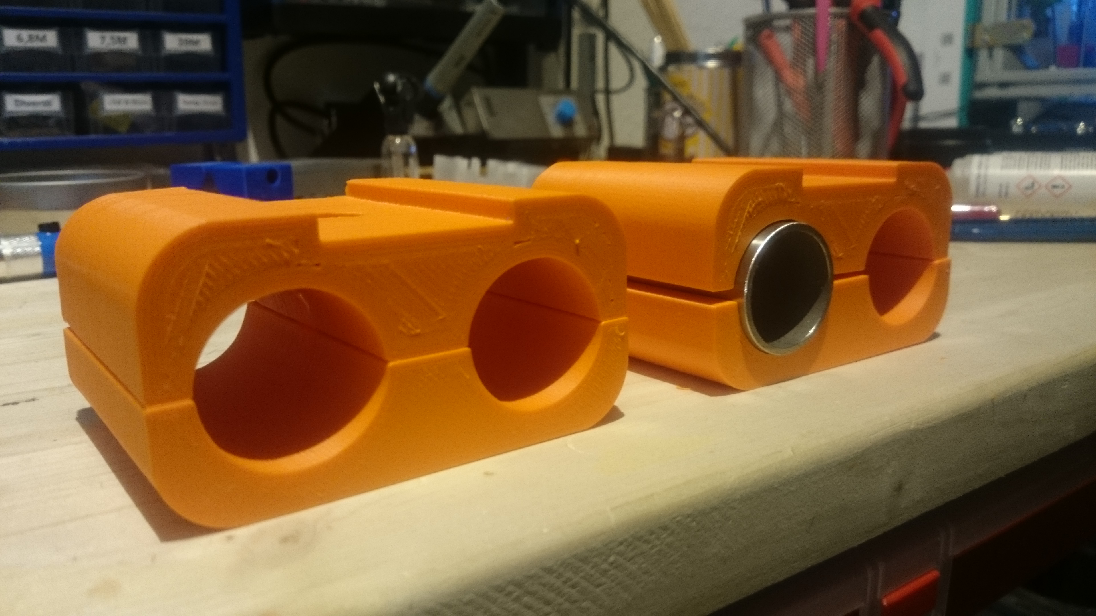

My dad is working on an engine bridge. Just printed the last parts.
Nozzledia: 0.8mm (e3d hardened steel)
Extrusionwidth: 1mm
Layerheight: 0.2mm
5 Perimeters
15% Infill
Ice Filaments Orange ABS
Hello
Pretty good prints… But with 0.8mm Nozzle, 0.2mm layers are looking low. You could have tried with 0.4 or more?
@Selvakumaran_Ganesan I could have. But I also used 1mm line width. 0.4 would have been even faster, but this parts need to be as strong as possible (for abs at least). This two holders should allow holding a dieselengine e.g.
The grove in the middle is for a piece of flat steel.
Very clean job.
@Dape_Part thx :wink:
