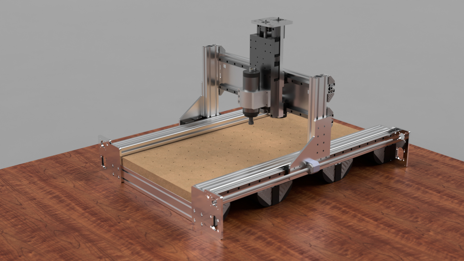

Have designed the mounting plates for Y-ballscrew/stepper and Z-stepper
I have designed the plates so I can use a belt/pulley configuration or direct
10mm quality alu

Did order pulley/belt kits for all motors today + the new alu plates Exiting
Would you please show me the backside of your project? I’m curious
Have not included all parts in the 3D model. The X-axis ballscrew is going to be installed in the front of the gantry - the x stepper on the rear side using a pulley/belt between them…
Ok, thank you. I like it very much!
Thank you - Soon Ill have all the parts so then Ill start shareing real photos from the build
I consider installing some plates like this to protect the ball-screws/rails from dust… - a bit higher + I have to include space for cable drag chains
