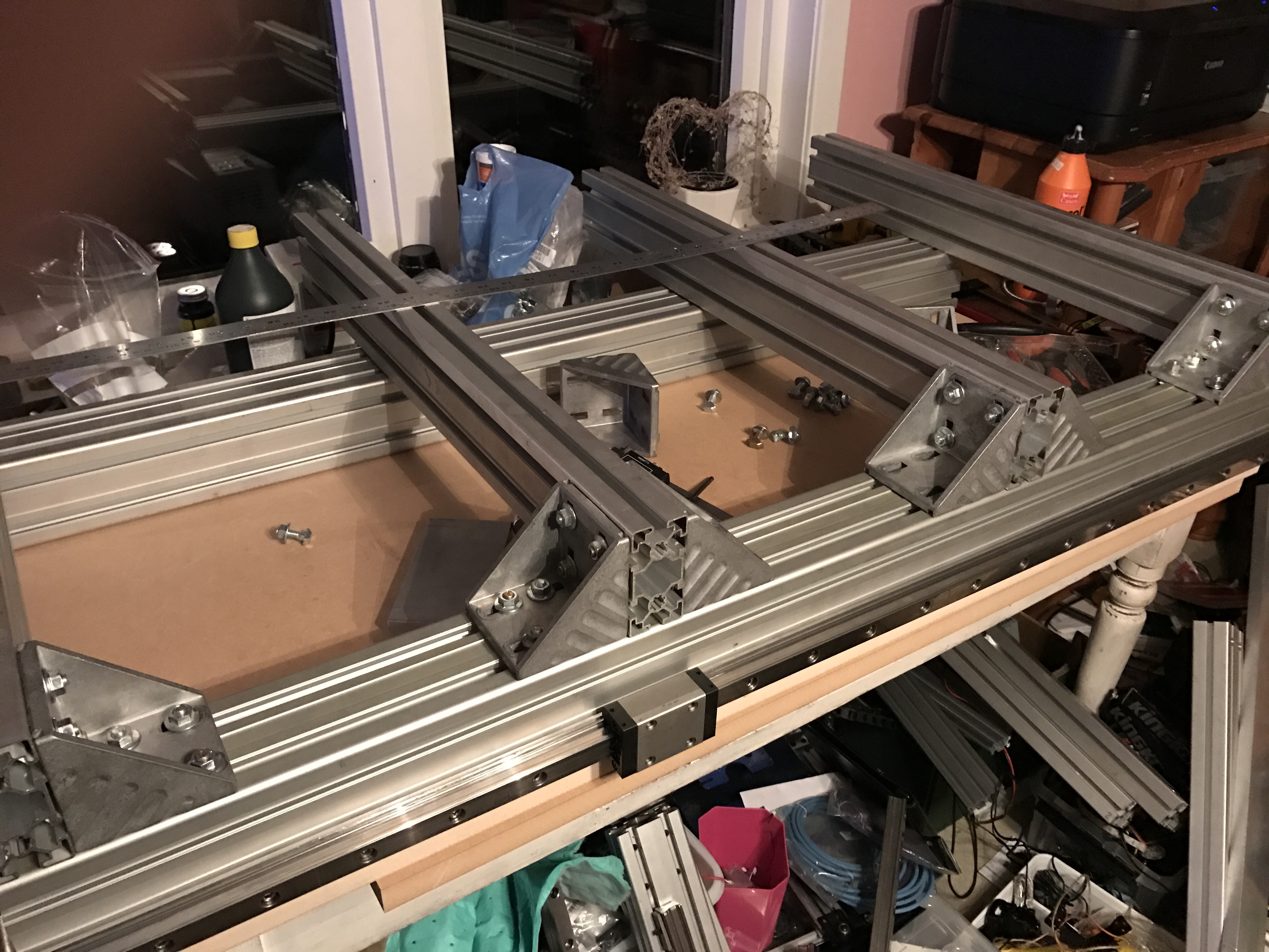

My diy cnc project - have started mounting the base frame. 9090 and 4590 profiles + Bosh Rexroth 25mm rails.
Have ordered 1610 ballscrew for the x-axis.

I have been looking around for someone with these larger extrusions handy. My rails use M10 mounting hardware. Do you think an M10 bolt and TNut will slide in the slot? https://www.aliexpress.com/item/20pcs-lot-M10-T-Sliding-Nut-Block-T-Slot-Nut-Aluminum-Accessories-4545-serie-Aluminum-Profile/32333403109.html

@Anthony_Webb search for Bosh Rexroth 9090 profiles.
My suggestion is to TIG weld each of the joints, once you have it setup exactly in each in their final position. The purpose is to stiffen up the frame, and to minimize any kind of flexing or movement. (Not to say I don’t like the saddle joints - as I do.) ANY flexing or slipping would yield dramatic, bad outcomes in your accuracy…
@Anthony_Webb http://www13.boschrexroth-us.com/Framing_Shop/Product/View_Product.aspx?category=10108&subcategory=2
@jeremy_nothum I do not have welding tools
