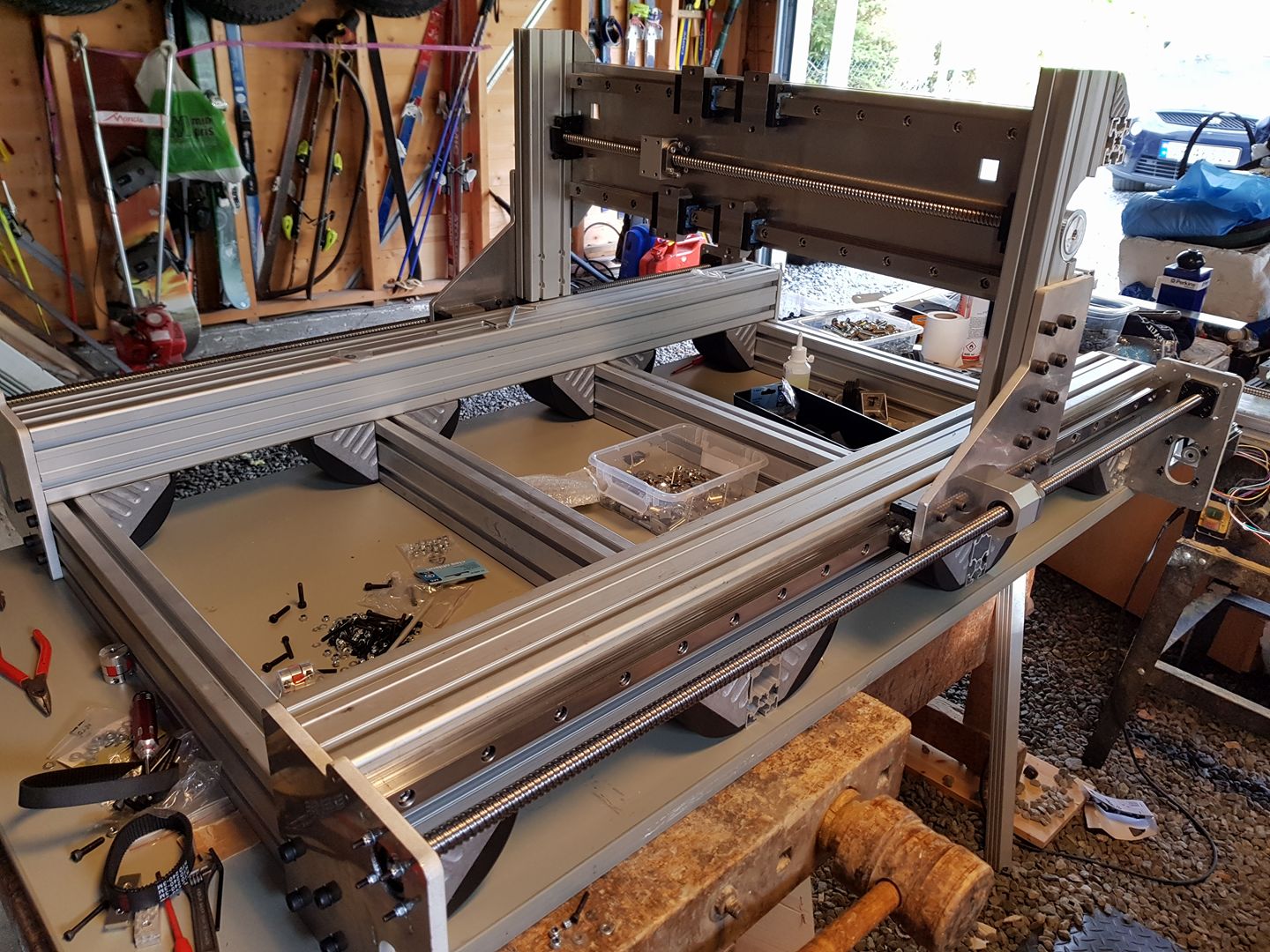

My DIY CNC project - started installing the Gantry
Looking more like an CNC milling machine
Next I have to adjust/align the x-axis before I can install the Z-axis

Looks good. Very similar to the one I built a few years ago using 80/20 extrusion, THK rails and NSK ballscrews.
@Jim_Fong This one is based on 90x90 and 90x45 Bosh rexroth profiles combined with 20mm Bosh Rails
Hope it is going to be ok
@Oyvind_Amundsen should be fine. 20mm rails can handle significant loads. I used 15mm on mine, which is plenty. A single 15mm carriage block handles 5kn load and there are four per axis!
