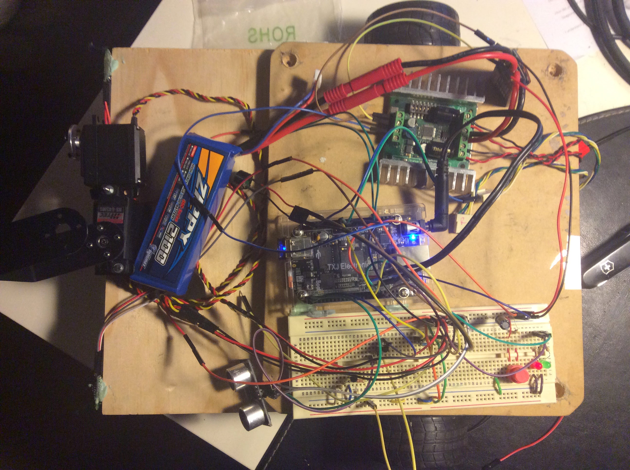

My dodgy BeagleBone Black powered robot.
Motor controller is a Sabertooth 2x12 driving two 12V DC motors, it also has a 5V, 1A output powering the BBB.
Collision avoidance is via a couple of (very) short range IR proximity sensors. Once I get the PRU sorted I should also have an HC-SR04 ultrasonic for longer range.
Control of the robot is achieved from a browser using WebSockets.
BBB - Python
Client - HTML/Javascript (Bootstrap, JQuery and some glue)
Code available at https://github.com/tdack/BBB-Bot
