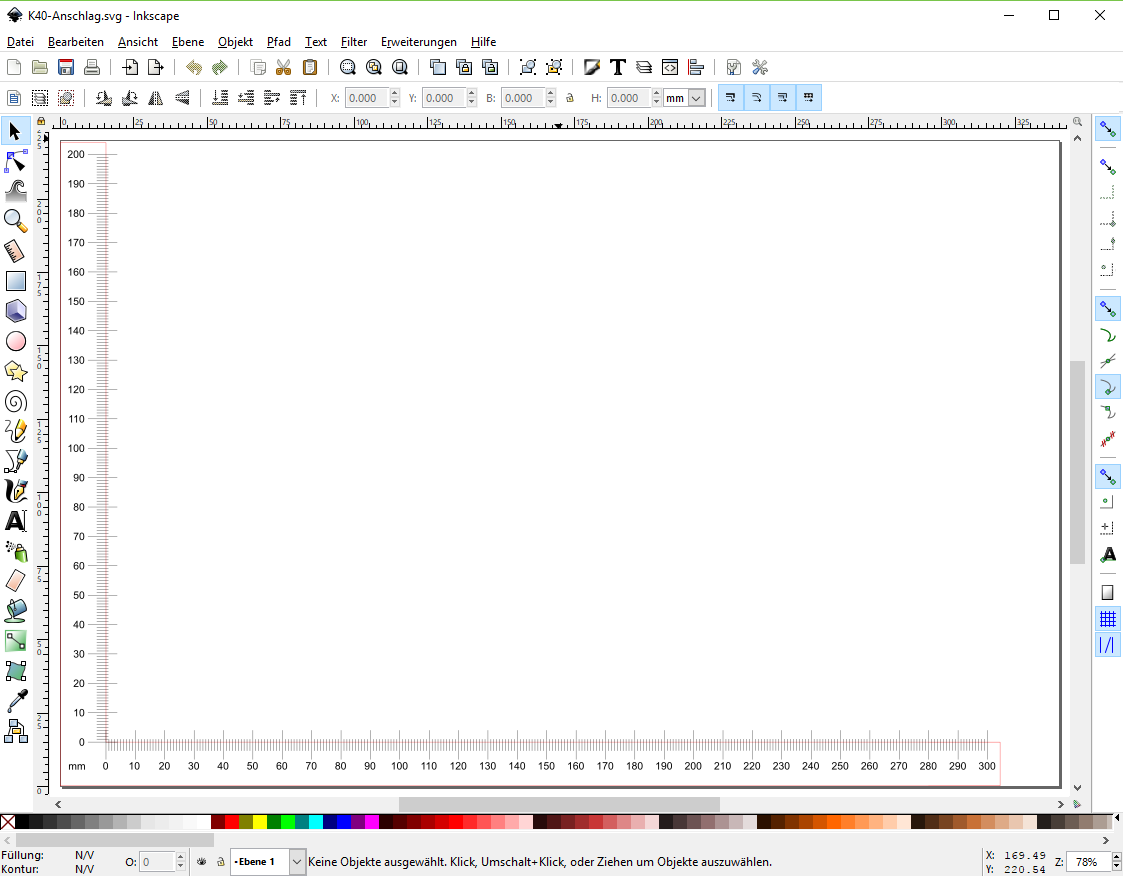

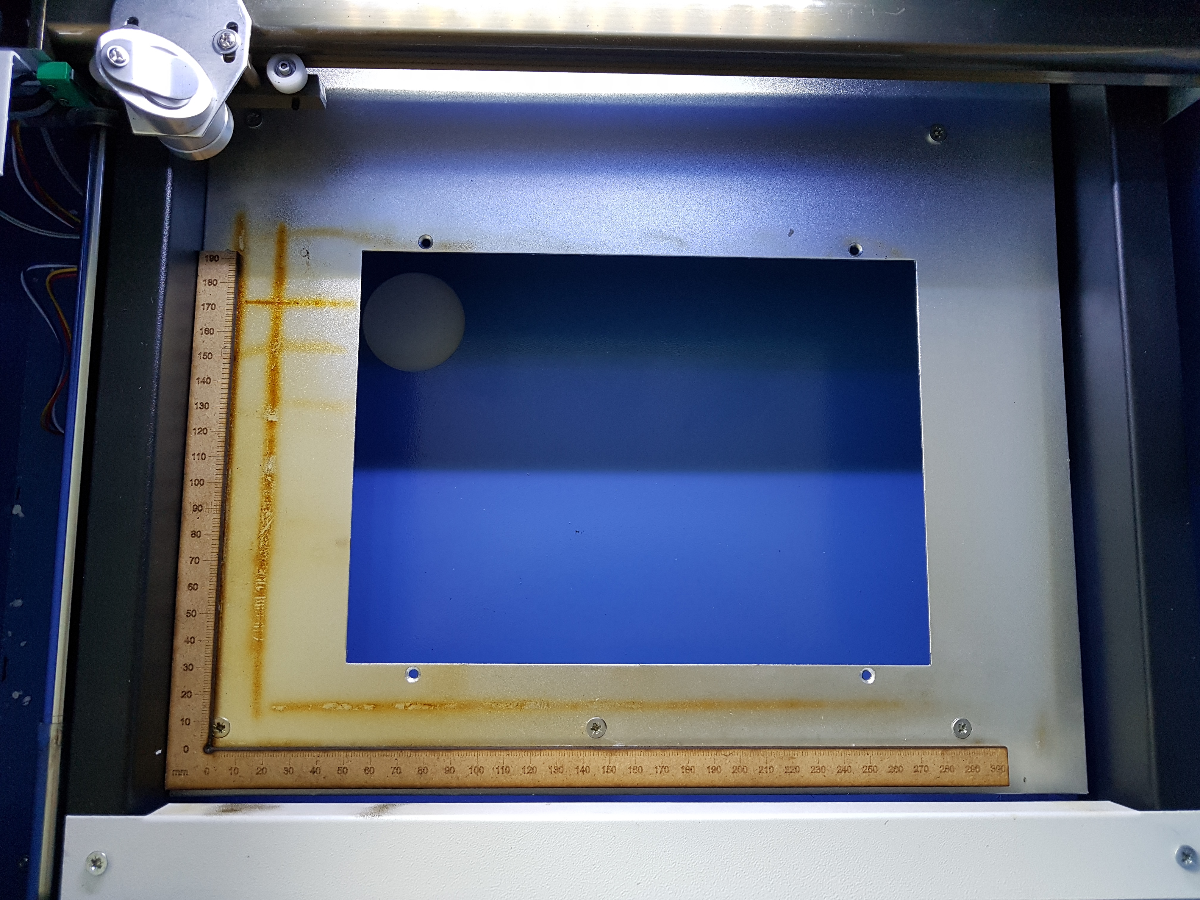

My entry for the #Laserwebcontest is a ruler / positioning guide for the K40.
Designed in Inkscape and used LW4 for CAM & production. Love the easy workflow ![]()
Yes!!! I did something like this with the stick on adhesive tape measures… But I feel we will see something really nice for the finished project from you @cprezzi ​
Has it made aligning things easier @cprezzi ​?
Yes, cuz I can place my raw material always at the same position and the rulers help to estimate, if there is enough material left for the job.
What is the advantage of the square in lower left corner compared to upper left corner?
Bottom left is where the default origin in LW4 is (so each axis work in positive direction) but it doesn’t realy matter where it is. You could also set your origin to top left.
