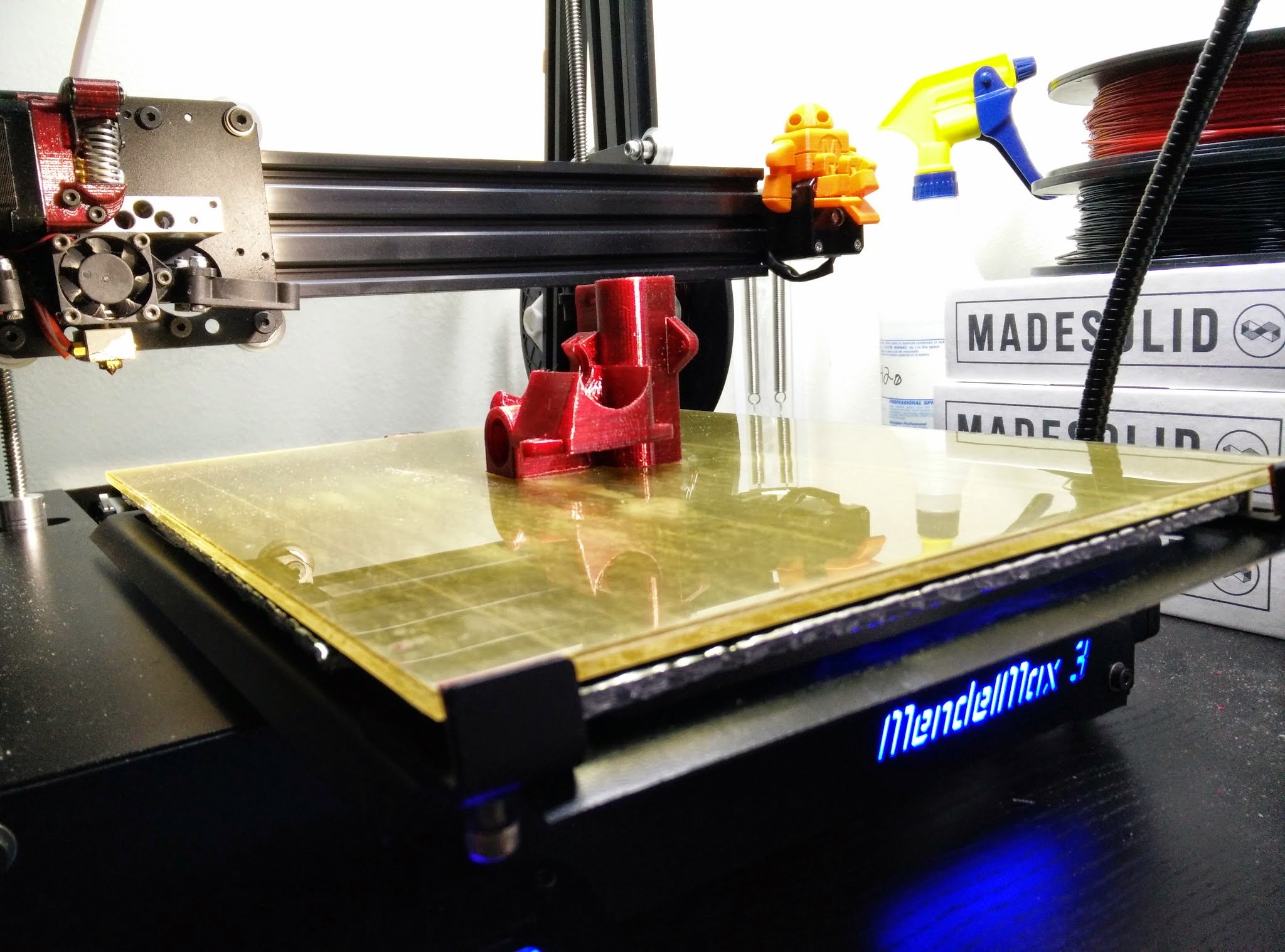

My Eustanthios build has begun! First part printed last night! @Eclsnowman 's V4 carriage.
Nice. Is that pet+?
Yes, PET+ Ruby Red. Hard to do a full plate though. It oozes quite a bit.
That looks really good ! I like the color
@Oliver_Schonrock with support. The photo of it right after the print didn’t look that great http://i.imgur.com/6JlwDgm.jpg
The gantry will be in PET+. Everything below will be in carbon fiber ABS.
@Oliver_Schonrock I used Slic3r 1.2.4 (experimental). There’s a newer one out now. Support and slicing times have vastly improved.
@Oliver_Schonrock The support inside the cable tie slots weren’t difficult to remove at all. I was expecting to use my dremel for the tie slots but wasn’t needed. Just a needle nose and a quick swipe with a blade to clean it up. Everything else peeled off without using tools. I wouldn’t be able to do this on 1.1.7 Stable with PET+. Weird though, I told slic3r to not support bridges and it still did.
Selectively adding or removing support like S3D would be great. Just being able to disable supporting holes would be a great start.
Hi @Anan_Leelasmanchai it’s PEI (Ultem) sheet. http://amzn.com/B00CPRDDLY
