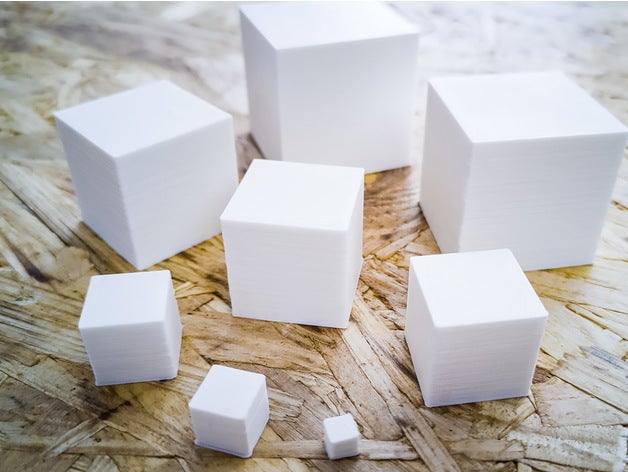

Can you print out a 20mm calibration cube? It would be easier to see what’s actually going on across the board.
