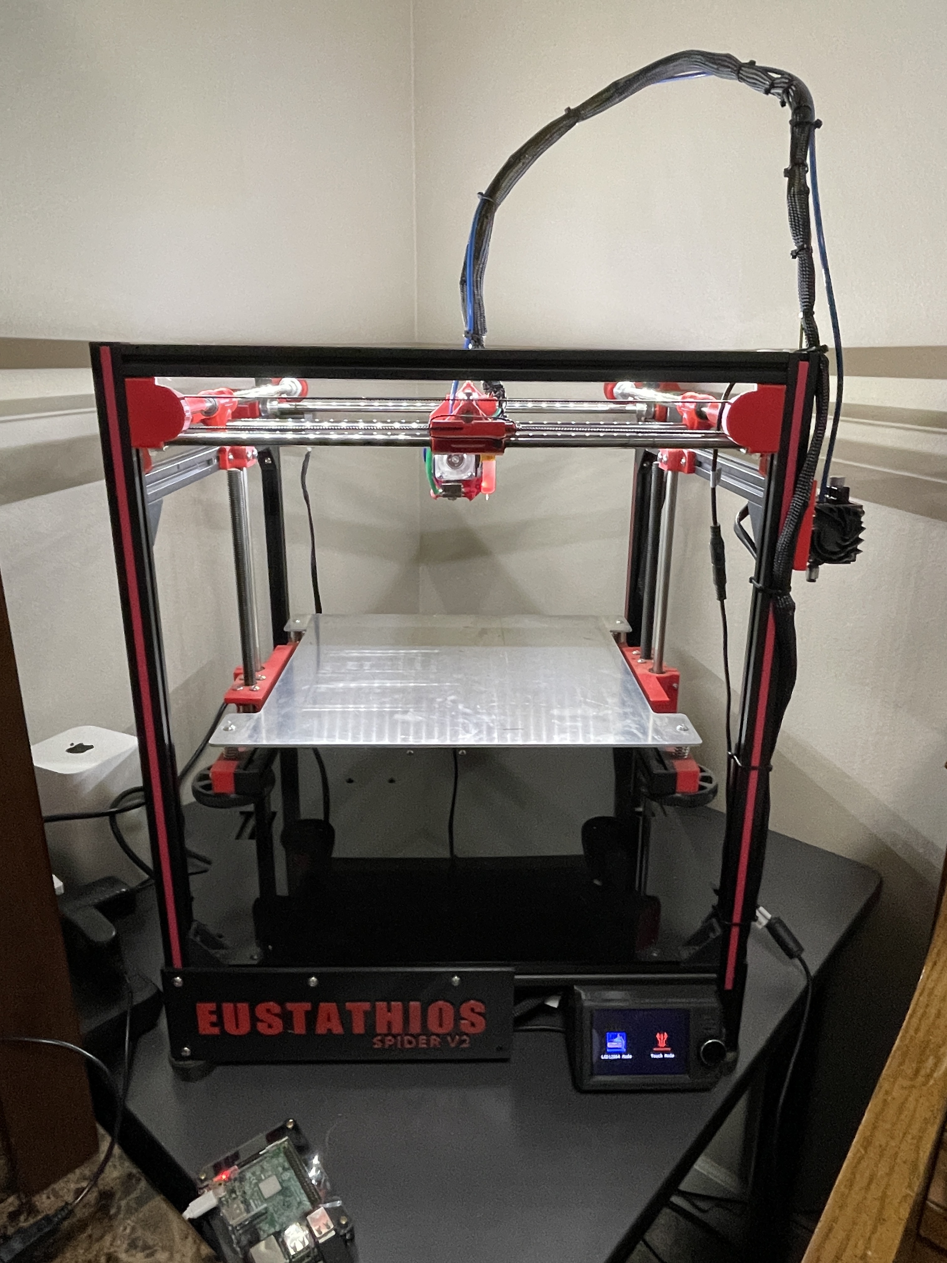

My Eustathios Spider V2.5 Build With Klipper
I’m attempting to bring my Eustathios Spider V2 back to life with version 2.5.
I’m using an SKR 1.3 with TMC2209 drivers and sensorless homing for X and Y.
I still have a few issues to work out. Not sure why but X and Y axis are not working correctly. I switched the wiring but X is still moving when I try to move the Y axis. Once I get this worked out I can work on sensorless homing.
I need to get the display working if it will with Klipper.
Here is my current config:

I’ve gotten a lot farther since this last post, My Z rotation distance wasn’t correct causing me all sorts of issues when I was trying to setup the BLTouch.
My next project will be making sure it can extrude filament. I also don’t have the display working.
One day at a time…
Good to see! I did something similar just recently, upgraded my Eustathios from Repetier/RAPS with Arduino due to Klipper/BTT Manta 4 with TMC5160 stepper drivers. Didn’t bother to keep the old monochrome display. Installed a pitft70 touch display and Klipperscreen. Much better than the lcd. Works quite well already, although I have to tweak some settings. Pressure advance does not seem to work (with 50cm bowden and 2.85mm filament). I’ll post more details later.
