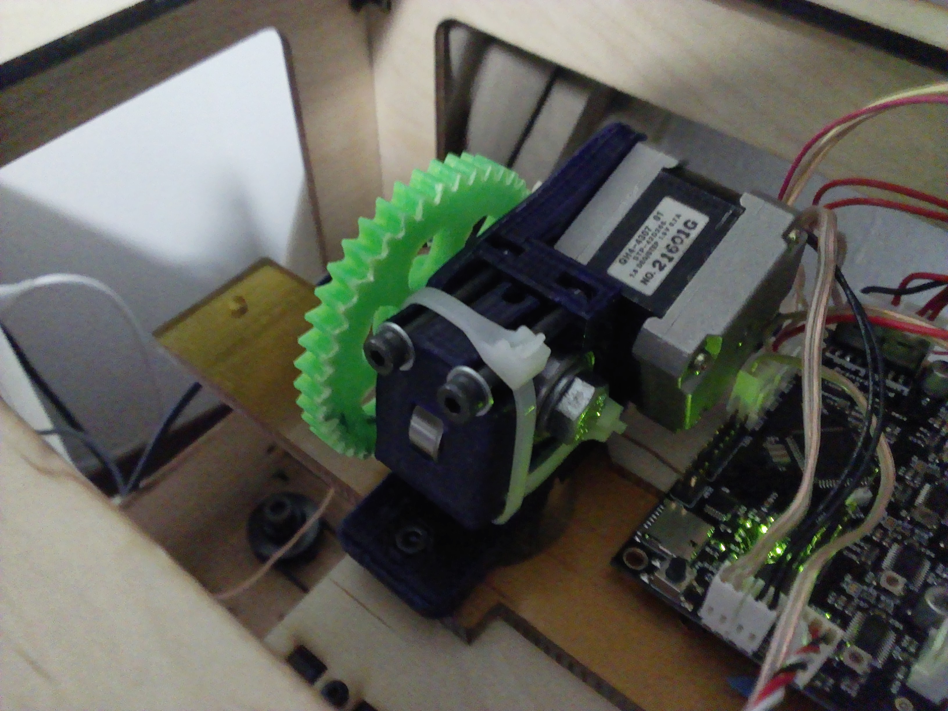

My extruder broke again today. Not even the epoxy could provide the strength.
My extruder broke again today. Not even the epoxy could provide the strength. My cheap hack to hopefully print long enough to make a replacement. Two zip ties. One around the base holding the idler to it’s hinge (the part the broke), and one around the idler assembly holding the idler tightening screws in place.
What broke? You know why it broke? Is a simple re-print all that’s needed to fix it?
Ill take a guess: What always breaks on those things, the ‘guidler’; overtighten those screws and the thing can split at the edge.

To clarify my extruder’s failure:
The idler hinge broke - probably from over-tightening, but I believe this block was printed at 25% infill, contributing to it’s weakness. I attempted to epoxy it, but still experienced another failure.
I can’t comment about springs being required for idler - it was delivered in mostly this condition to me, a kind friend printed it for me to get my printer working. I’ve had mixed feelings about how best to the solve the problems I’ve faced. Mostly I just want to get to a replacement that will work. I’ve been tempted to get a water-jet cut extruder block and be done with it. But I have what I have to work with.
