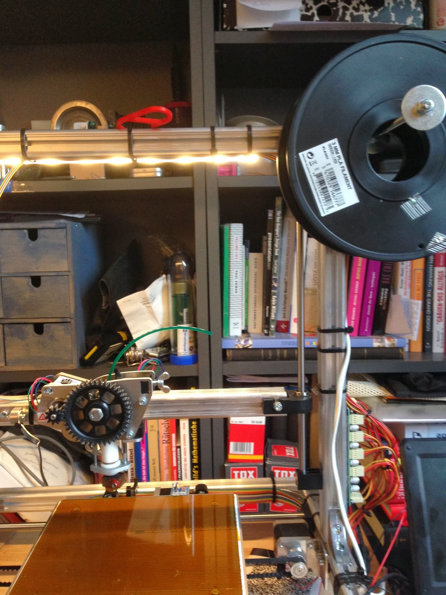

My filament always break when the printer is stillstanding for 2 days.
My filament always break when the printer is stillstanding for 2 days. Nobody touched it meanwhile. The room temp is between 16 and 22 °C.
Filament is PLA from Velleman. Happened with transparent, red and green so far. What might be the reason? How to change that?
