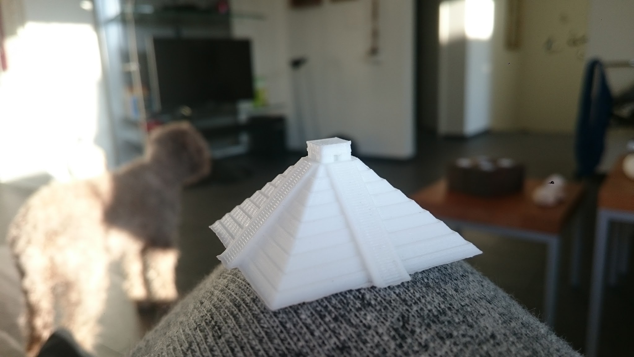

My first 3D print! I'm pretty amazed by the print quality of the Anet
My first 3D print! I’m pretty amazed by the print quality of the Anet A8. I didn’t even leveled the bed! The only thing I struggle with is how I get the prints from the bed. They are really strong attached on the bed. Any suggestions?

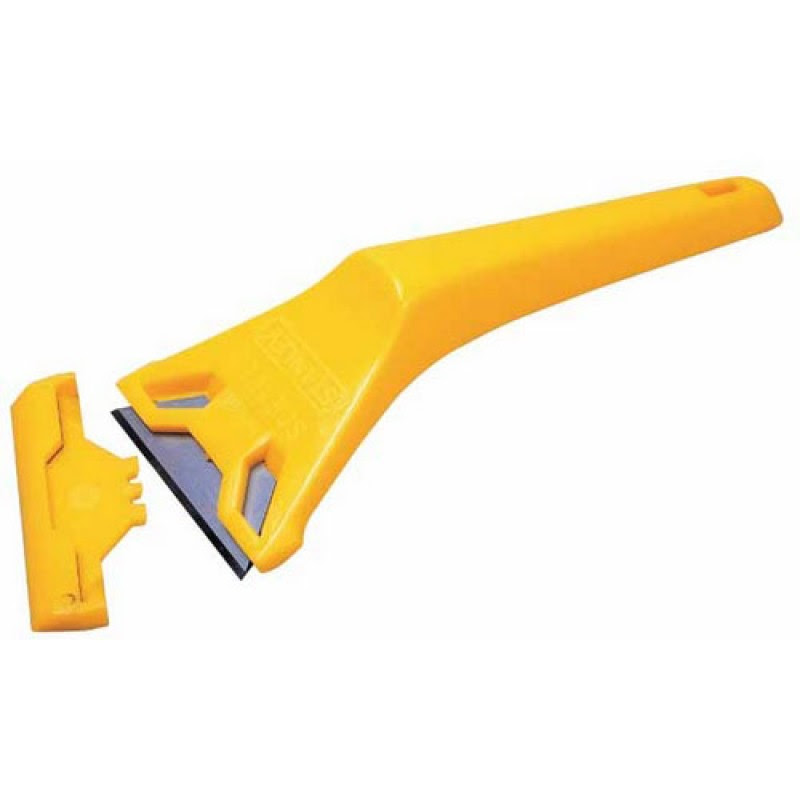

I use a stanley window scraper. Tap it around the edges then a big tap and it comes straight off.
