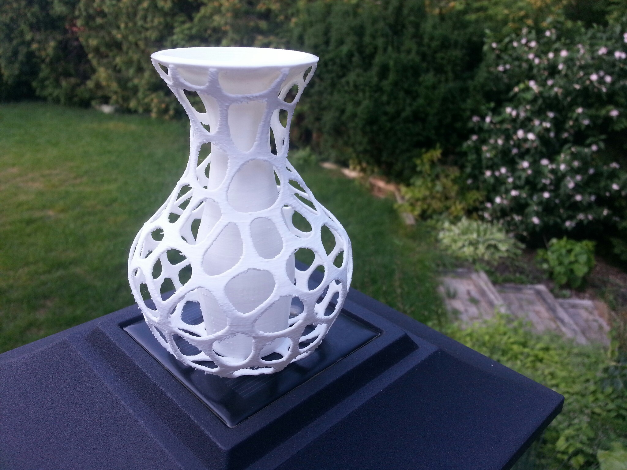

My first attempt at designing a vase. I used Rhino and Meshlab.
My first attempt at designing a vase. I used Rhino and Meshlab. Printed in PLA with an Ultimaker.
not bad at all smooth it off and give it a nice finish/colour you have a custom product. quality.
Care to provide some details on what you did with Rhino and Meshlab?
Design outer vase as a solid
Export to MeshLab
Voronoi-fy it. (look at this guide - http://meshlabstuff.blogspot.ca/2009/03/creating-voronoi-sphere.html)
Import back to your CAD
Make inner vase
Combine, cleanup (this is hard) and prepare for 3D printing (Close holes, fix manifoldness)

Looks like it’s made of two materials. Is the inner part ceramic?
Nope, it’s all plastic. I will release the STL in 30 days once the experiment is over :slight_smile:
