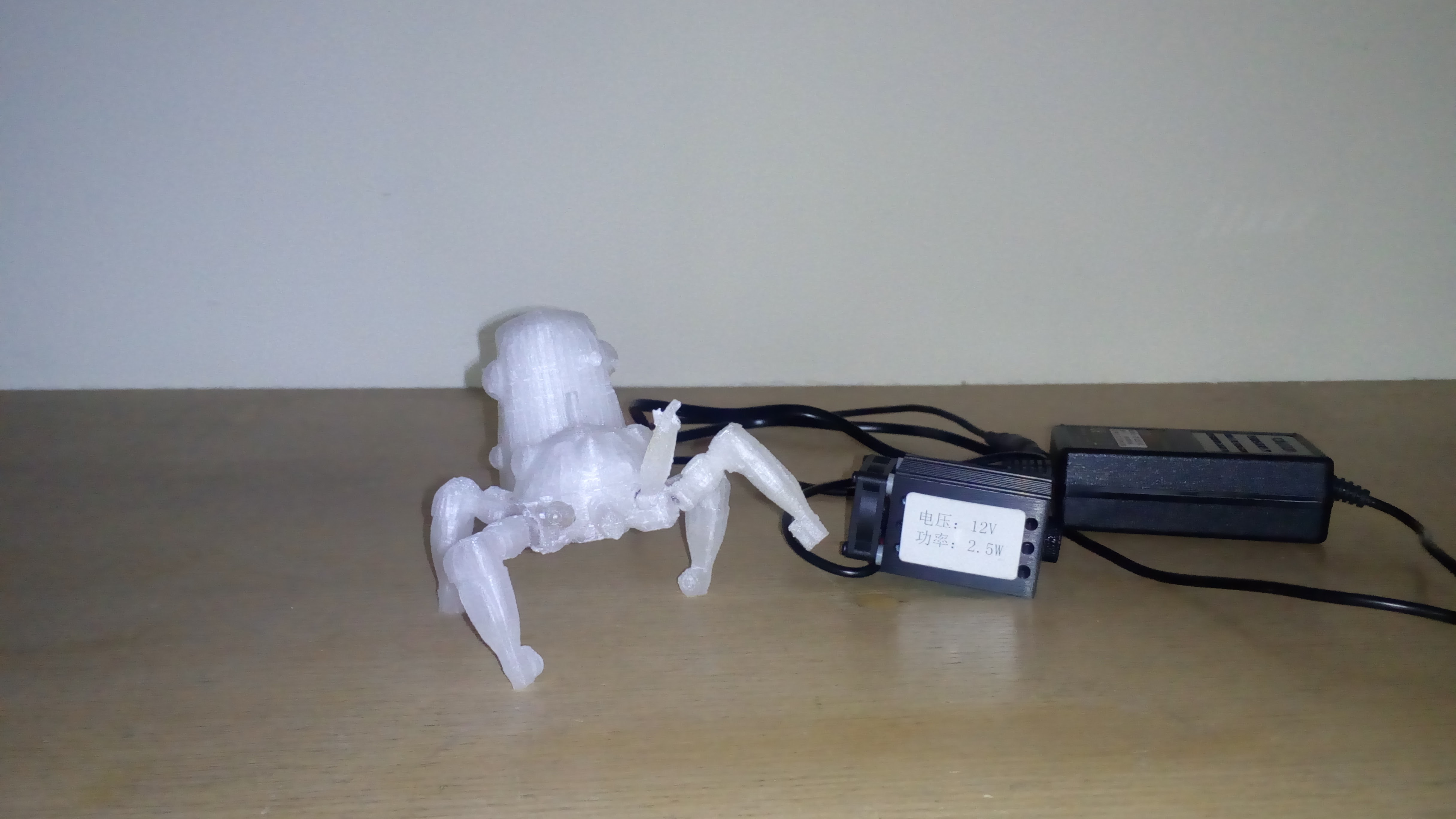

My first complex print.
My first complex print. It took all evening and all night. Poor thing had it’s legs and arms came off while I was cleaning it up after printing it. I welded them back with a laser. ABS let’s laser light through so I painted small black dots with black marker and heated them up from outside with laser.

Welding ABS with a laser…hmmmm…now that’s an idea…
Is that a 2.5 watt laser?!?!?!?!?!?
Could have used abs pipe cement to glue them back on
@Alexander_Pritchard Yes.
