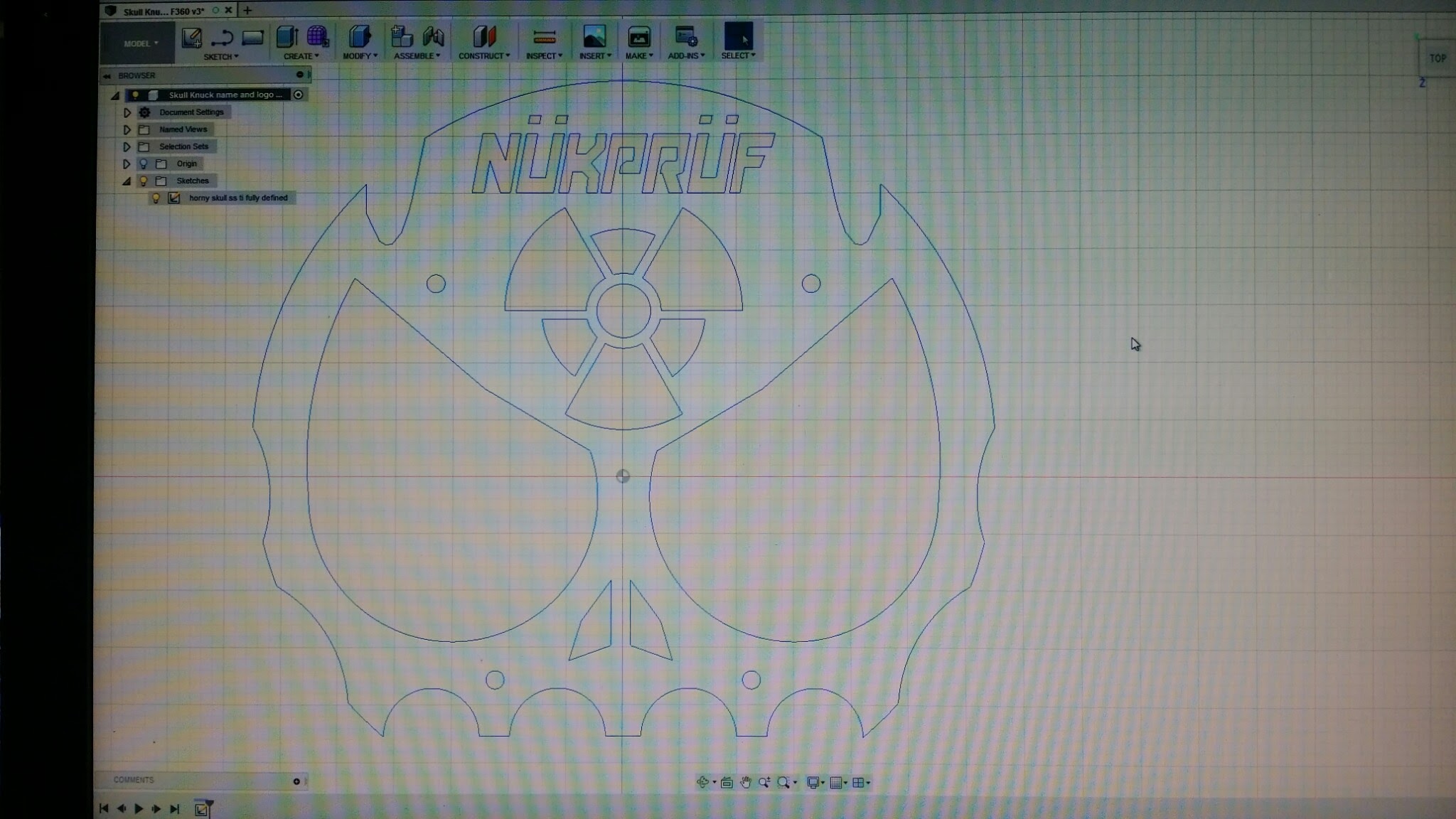

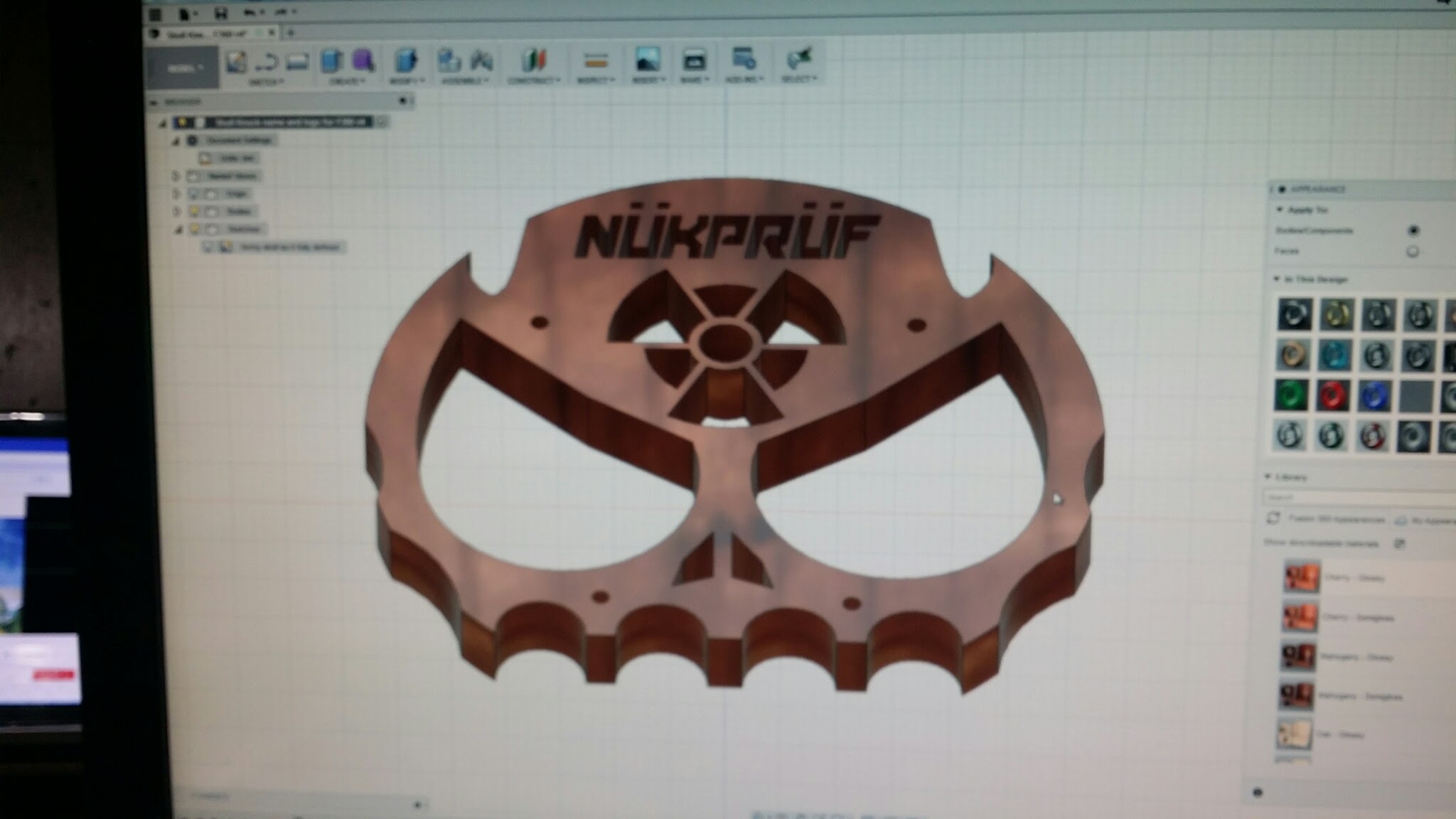

@Darren_Lee I’m liking Fusion 360 so far! But I am trying to extrude and it has the wrong areas shaded or selected and I can’t reverse it. In the picture it has the eyes,nose, name and logo selected but I only want the skull selected. Any idea on how to reverse it? I have tried to look for videos or discussions with no luck. Thanks
You may want to create a block that represents the stock you will be cutting. Then reverse extrude the eyes, name, logo etc into the block (remove from the block). This essentially would create a “negative” 3D part, which is what I think you want in this case?
@Darren_Lee I want to cut the shape of the skull out along with and the eyes, nose, name and logo. I’m thinking maybe I have a gap in the skull outer lines somewhere but not sure how to check it in Fusion. This is an imported dxf from Solidworks and it was fully defined when I exported it so there really shouldn’t be a gap.
@Darren_Lee Fixed it! It was a gap!
