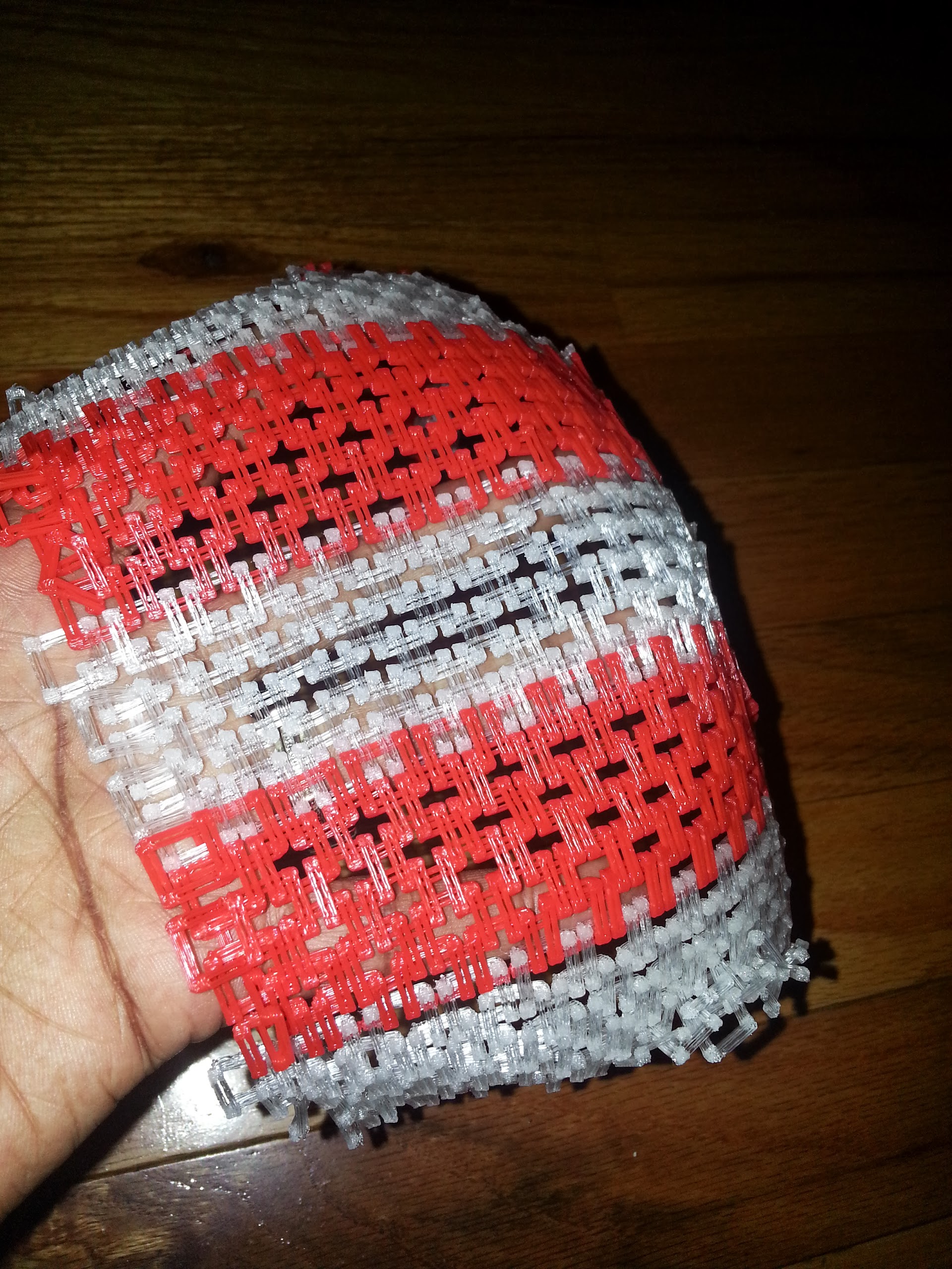

My first "Ditto" print using Sailfish.
My first “Ditto” print using Sailfish. This is a chainmail using both extruders at the same time. thing:68848 on thingiverse.
Very Cool.
that is cool, are the pieces connected or do they move freely?
How’s your experience with sailfish been. Debating on installing. What are you using to slice?
So the stripe widths is the distance between your two extruders?
@zephyrin_JG They move freely. They are just linked together.
@Eric_Moy I had a couple hiccups with the installation and bricked(?) my machine. The tricky part is when you have to hit upload and press reset.I kept clicking both at different intervals as I’ve read you have to push reset then immediately hit upload. Impatient me didn’t understand that you should wait after you do it once and I kept clicking. It appears as if nothing is happening but the machine is processing. I had to re-install the Makerbot firmware and then tried again with sailfish. After I installed sailfish, I used ReplicatorG 40 Sailfish. However, the chainmail was sliced in Makerware. Sailfish is faster by the slicing takes a lot longer in RepG.
@Josh_Ajima Yes, they are. Here is how it was done http://www.thingiverse.com/thing:68848/#instructions.
@Eric_Moy I’m sorry, I did you RepG to slice this, it took a really long time to slice.

@Eric_Moy I downloaded the Openscad file as GPX I’m not familiar with. Lol, I’m still in the baby stage of 3d printing. From openscad I exported the .stl and sliced it in RepG 40 which took forever.
