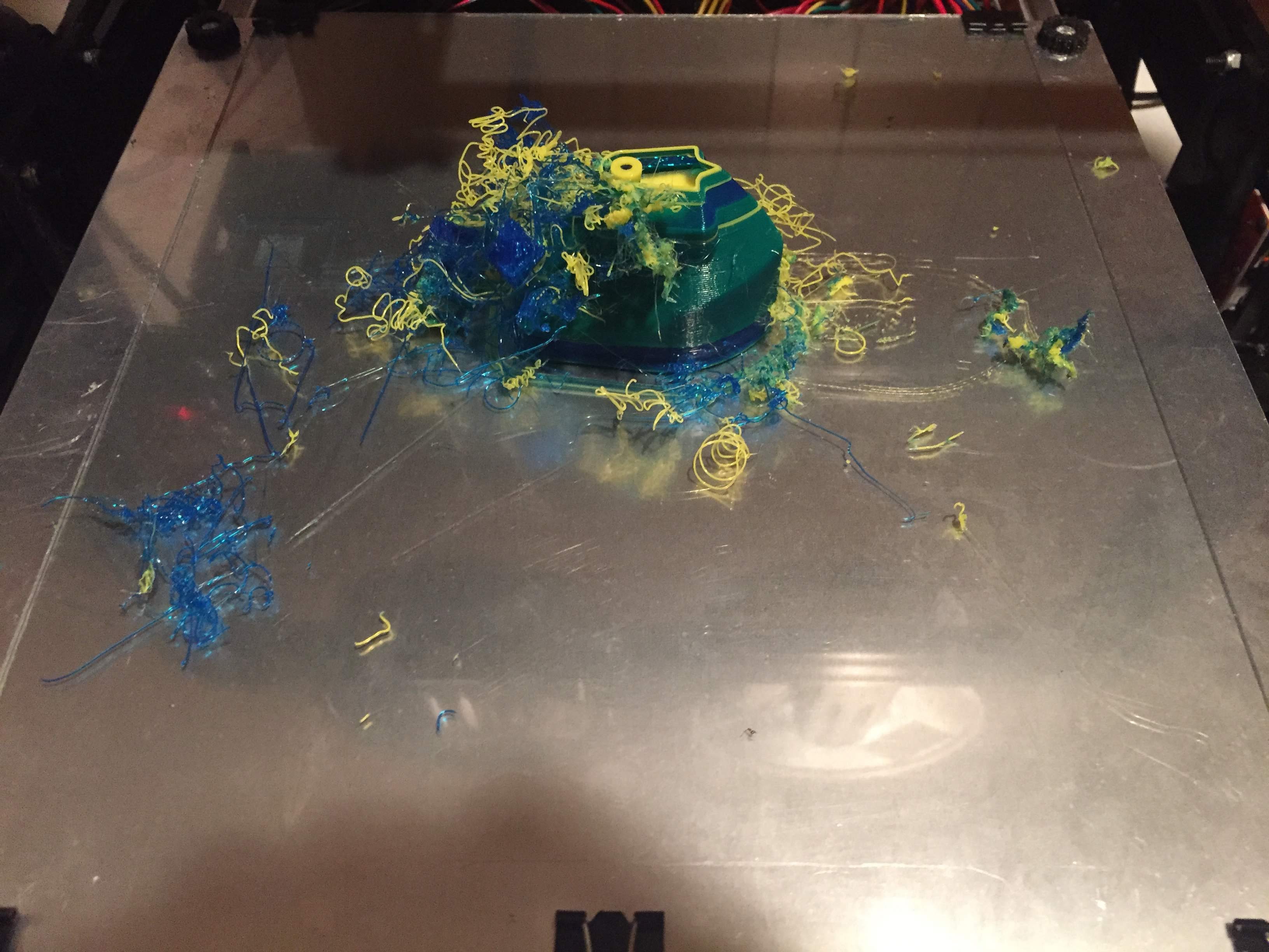

My @3DBenchy , dual extrusion model, on my own design Cohesion3D printer with 10x10 heated glass and dual E3Dv6’s.
I chose blue and yellow because they mix well, so if there was an issue we would have a very distinct green blob on the printout.
Sliced with Simplify3D using an ooze shield and prime pillar, the pillar fell over about half way through so that’s where all the “hair” is from.
I’m still playing around with the retraction settings a bit, as 6mm on tool change leaked a lot but 12 is too far in and causes clogs. I’ve just started another print of this using 8mm on tool change and lowered the temp a bit to further decrease ooze.
Overall, quite happy, especially with the crisp color separation.
.2 layer height, 2 perimeters, ESUN PLA from microcenter, and some very good cooling.
