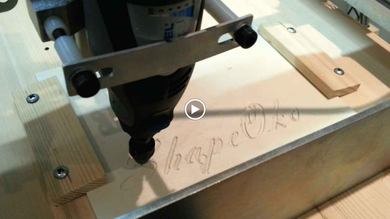

My first engraving after finally assembling the ShapeOko.
Dremel 300, 0.8mm ball endmill.
TinyG, Nema 17 steppers, dual Y axis.
Feed rate 500, step down 0.5mm, step over 40%. 3 passes.
Made text in Inkscape, CAM with MakerCam. Gcode with tgFX.
Wood; some kind of plywood?
