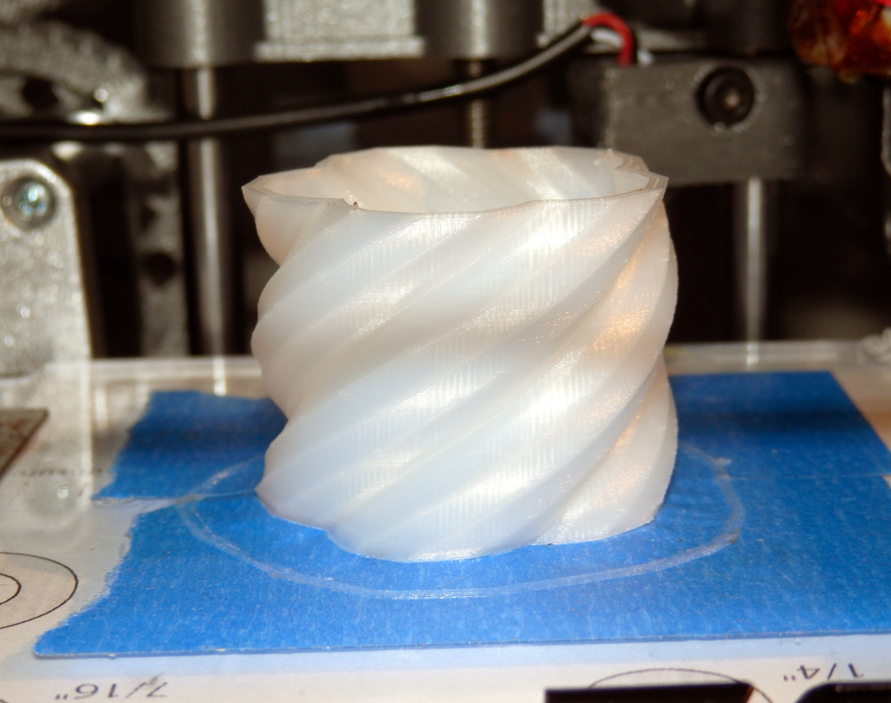

My first few prints with Taulman 618 Nylon (1.75mm) on a Tantillus -
Amazing layer bonding with this material, even at low (220 deg C ) temperatures.
Strong but flexible.
Just printing on cold Blue 3M tape at the moment, not much warp.

How slick is it? Could printed bearings actually be worth doing for once?
It would be interesting to see how it wears and you may need to make more of a solid bushing rather than the ‘spiral’ types of PLA LM8UU replacements used by some.
But it feels quite smooth and slick, the best quality finish I have seen, even better than a well tuned ABS print.

@Michael_Moskie Yes, I can’t see any difference in print strength or quality when printing at 220 or 240, so I’ll try going even lower next time and see what happens.
At 240 it does go brown when stuck on the hot-end for a few minutes, so I’m keen to keep the temperature as low as possible.
