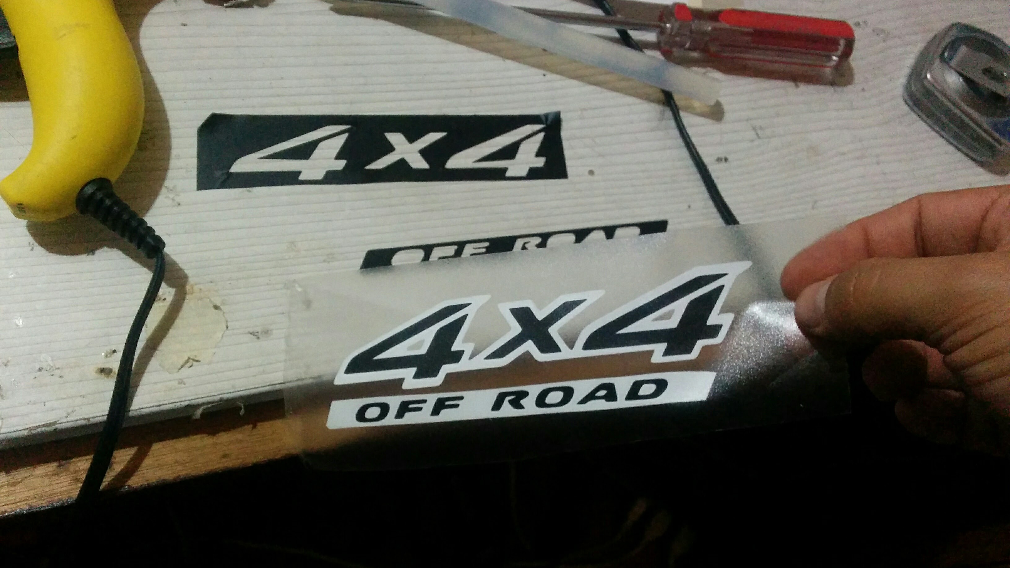

My first Home Made Vinyl Stiker
Cool. How’d you get the 2 colors? Did you use a blade?
What did you cut it on?
@jlauer The white and black colors are separated parts. Also are separated gcodes.
I used a roland drag knife
