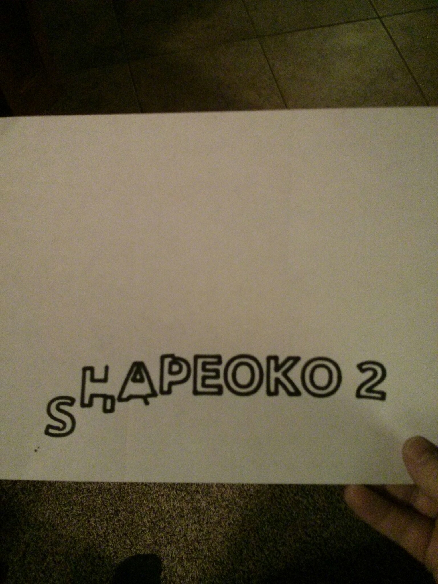

My first job didn't go exactly as planned...
My first job didn’t go exactly as planned…
Are you using a grbl shield? I had to turn up my Y axis current slightly to prevent missed steps like yours. There’s a page on the wiki about making that adjustment.
Paper moved with the pen?
I am using the grbl shield. I will check out the wiki, thanks @Chris_Miller .
Adjusted my Y axis current, works perfectly now! Thanks @Chris_Miller
