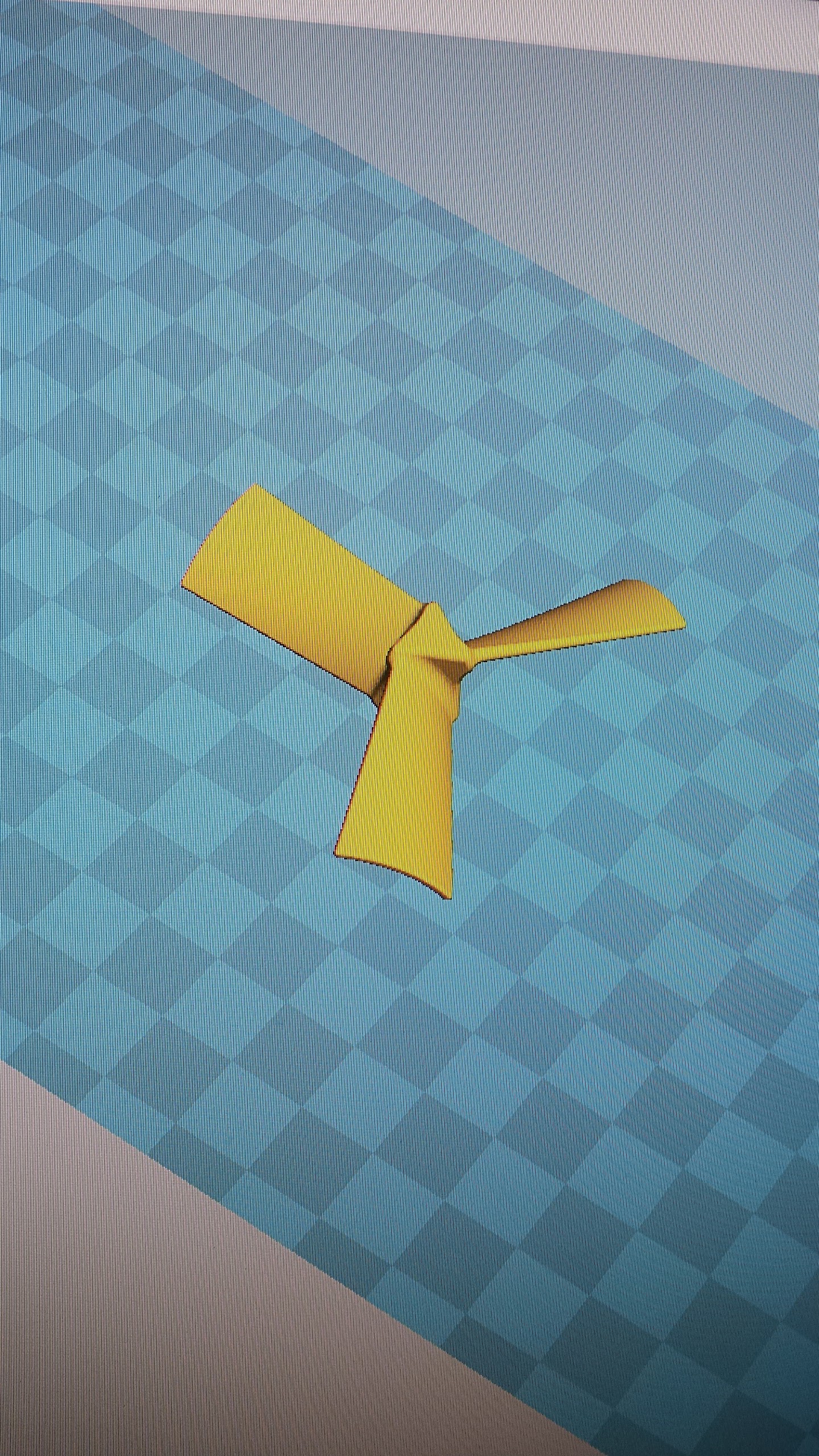

Progress update: due to a bad design on my part i had to restart the print, i didnt notice it was starting mid air and was using to much supports. Cut off some of the bottom and started again.
