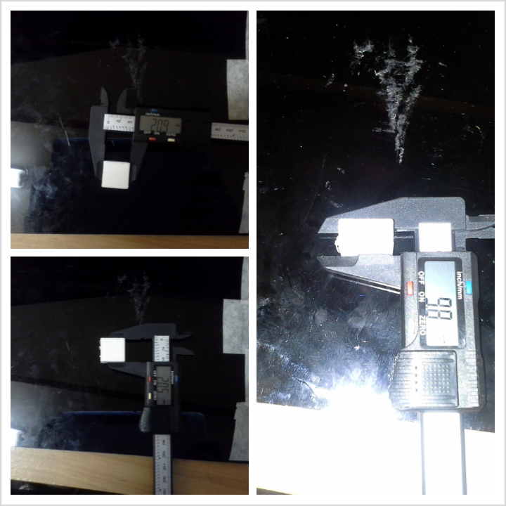

My first print on the Graber i3, with an Aluhotend. Repetier Firmware, Slic3r, Repetier Host. Calibration cube, meant to be 20x20x10mm. Pretty happy with this. Got 20.5, 20.9, 9.8mm, printing at 0.1. The Z is definitely bed calibration, wasnt perfect.
