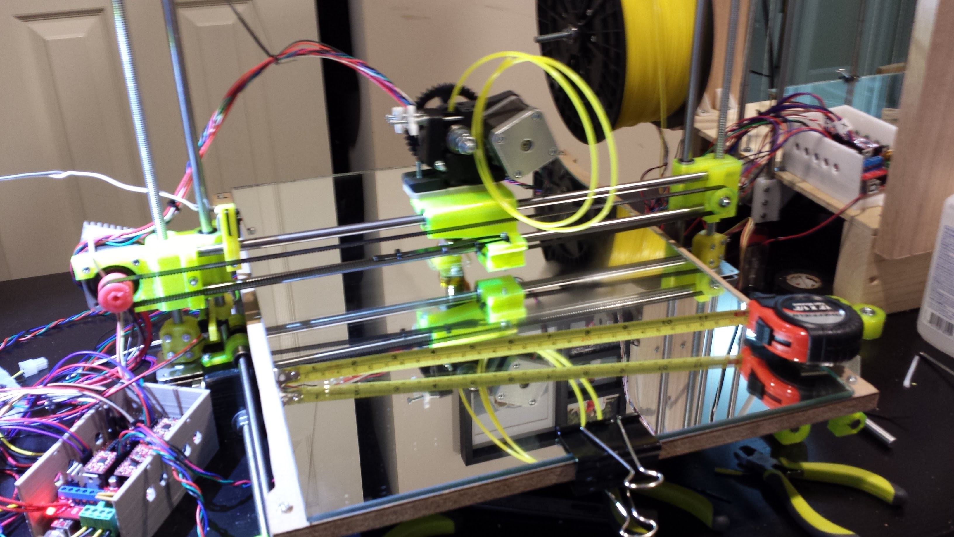

My first print with my new reprap wallace xl.
8mm rods that were longer then original.
Print area: 240x290x270.so far looks good, I can’t wait for large print tests.
What hotend did you use?
J-head hotend 0.5mm. I got it with fit with extension. Because extruded mount is too high. My next upgrade will be change of that.
I have redesigned that carriage to accept a E3D hotend. I moved the extruder mount down almost 1 inch. The stepper is close to the smooth bar now. It can be seen here. https://www.facebook.com/photo.php?fbid=281596651988954&set=a.272794046202548.1073741829.271424443006175&type=1&theater. If you would like the stl just pm me on fb from the link.
thank you, sent a message
Nice. I stretched the Y on a Wallace ++ I’m playing with but nothing like this.
@Mateusz_Perlak File sent.
@Stephen_Nolen Thanks. I also made different endstop brackets and harness holder. Not sure if you were able to see those in the pictures.
@Wayne_Friedt Looks really nice man. I need to get some steppers and electronics ordered
