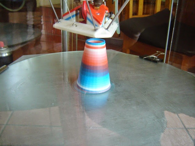

My first print with Repetier’s colour mixing firmware (http://www.repetier.com/firmware/v092/index.html ) using a Tri-colour hotend (Tri colour all metal hotend (3d printing head) with single nozzle for a delta printer )
More about the Repetier firmware where one can use up to 16 colours in any combination to print. Colours can be changed in real time with the EEPROM configuration in Repetier-Host or one can have it in the g-code.

I’m impressed that such a small amount of contact between the cut down MIG tips and the cooling block is enough… And it looks like it works well!
ABS or PLA?
Next step: a model of earth printed in blue+green?
@Electra_Flarefire I am printing with ABS at the moment. Have not tried PLA with the Tri-colour.
