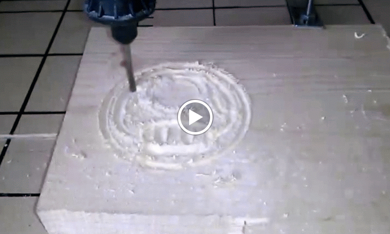

My first proper cuts with my cheap clamping system.
Anyone have tips on reducing burs?
Originally shared by Nathaniel Stenzel
Not exactly a useful item, but it looks like it is cutting right. I just wish I did not have so many burs to clean up.
Go over it lightly with a sanding sponge and it will take the splinters off.
@Chris_Miller Thanks. I figured something like that would work. I just was not sure if there was another step that people tend to do. I guess it is the most obvious of solutions.
Straight flute bits also produce less tearout in wood.

Downward spiral cutting bit. Will make a big difference. Especially in plywood

@NathanielStenzel I would recommend the quiet cut spindle upgrade. I did that and haven’t looked back, mostly because I can hear what’s behind me now!
Well, I noticed a little bit ago that my dremel must not have been straight, so I fixed that with a couple of washers to shim the angle. It looks straight now.
