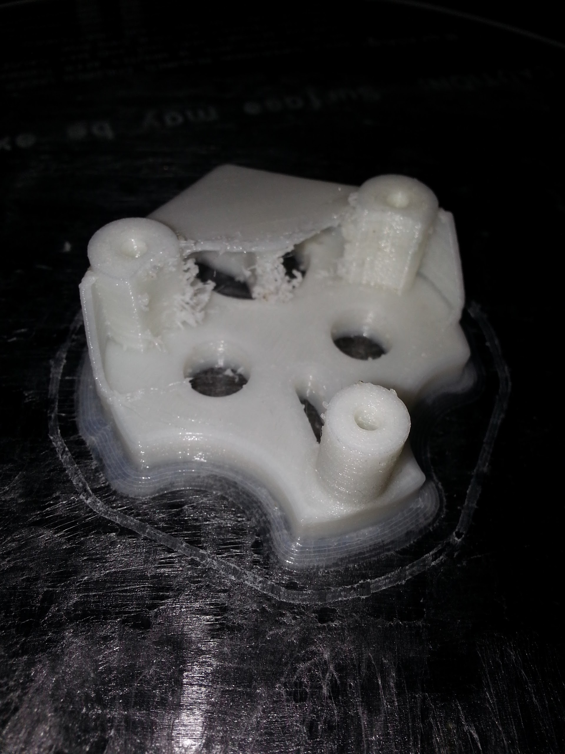

My first successful nylon print! Gluestick on 40 C borosilicate.
My first successful nylon print! Gluestick on 40 C borosilicate. Needs work on retraction settings but super smooth extrusion at 245.
Very cool
I am surprised to see you were able to get Nylon to stick to glass using glue stick. This worked well for you?
