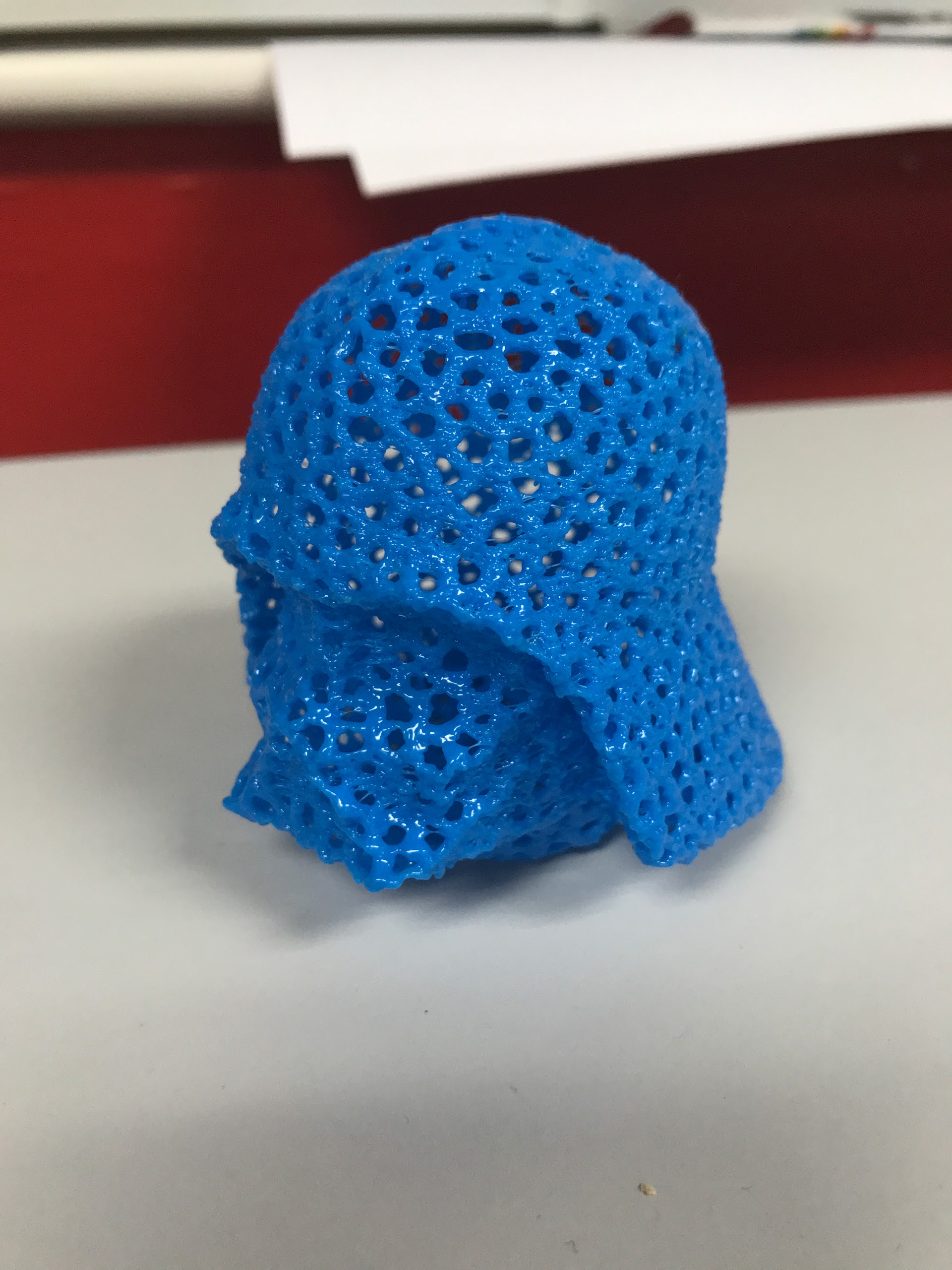

My first use of Polysmooth. Transparent Polysmooth before and after Polyshing. 0.15mm layer height on an Original Prusa i3 MK2S. 40min Polyshing with 99.9% IPA. Result!
Possibly even a game changer?
Whats that? Looks interesting
@Thomas_Sanladerer Have you tried this? In regards to your latest video about polishing.
@Daniel_Stauffer It was a kickstarter I backed. Arrived a couple of days ago. So far, very impressed. https://www.kickstarter.com/projects/polymaker/polysmooth-and-polysher-3d-prints-without-layers
Looks very impressive
@Mark_Wheadon I’ve been watching this for a long time. Missed the Kickstarter. Looks like a really nice alternative to ABS and acetone smoothing.
Question: How does the filament perform at keeping tolerances and precise dimensions?
No idea yet I’m afraid. It seems to be well behaved when printing so I guess there isn’t much shrinkage whilst printing.
Any noticeable deformation when smoothing?
I wonder how sharp corners will be after smoothing.
@Shai_Schechter not tried it yet.
@Mark_Wheadon any experience with chemical resistance or long term stability of the printed parts?
@Thomas_Sanladerer That’s my first print and it’s only a day old so no, not yet.
@PrintinAddiction no noticeable deformation so far. I’ll know more about loss of detail etc when I’ve had more experience of it.
nice!
Ok, that’s pretty cool!
@Mark_Wheadon wow… it doesnt even look 3D printed after polishing…
@Cristian_Martinez that is the entire point!
