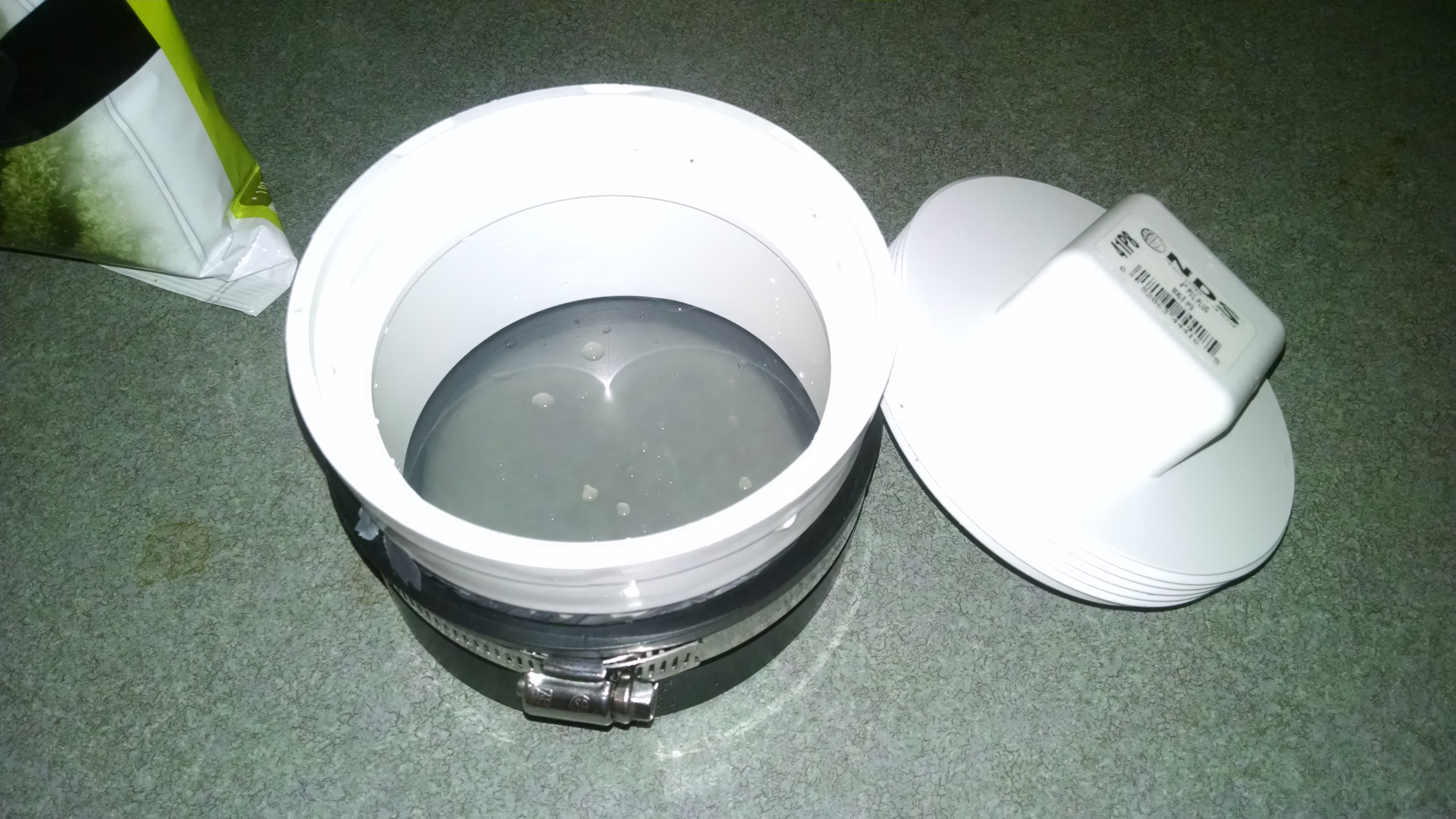

My flexible bottom tank for my home built wip dlp printer.
My flexible bottom tank for my home built wip dlp printer. 4 inch female pipe insert and 4 inch rubber endcap with hole cut out. Watertight tested with polyethylene. Will use fep film in final printer. They make 6 inch as well but I wanted a cheaper test.
What kind of SLA printer do you have?
None, working on a homebrew DLP style printer. Planning for ~$1000 total price including LCOS based projector.
Nice, going to use Creation Workshop?
