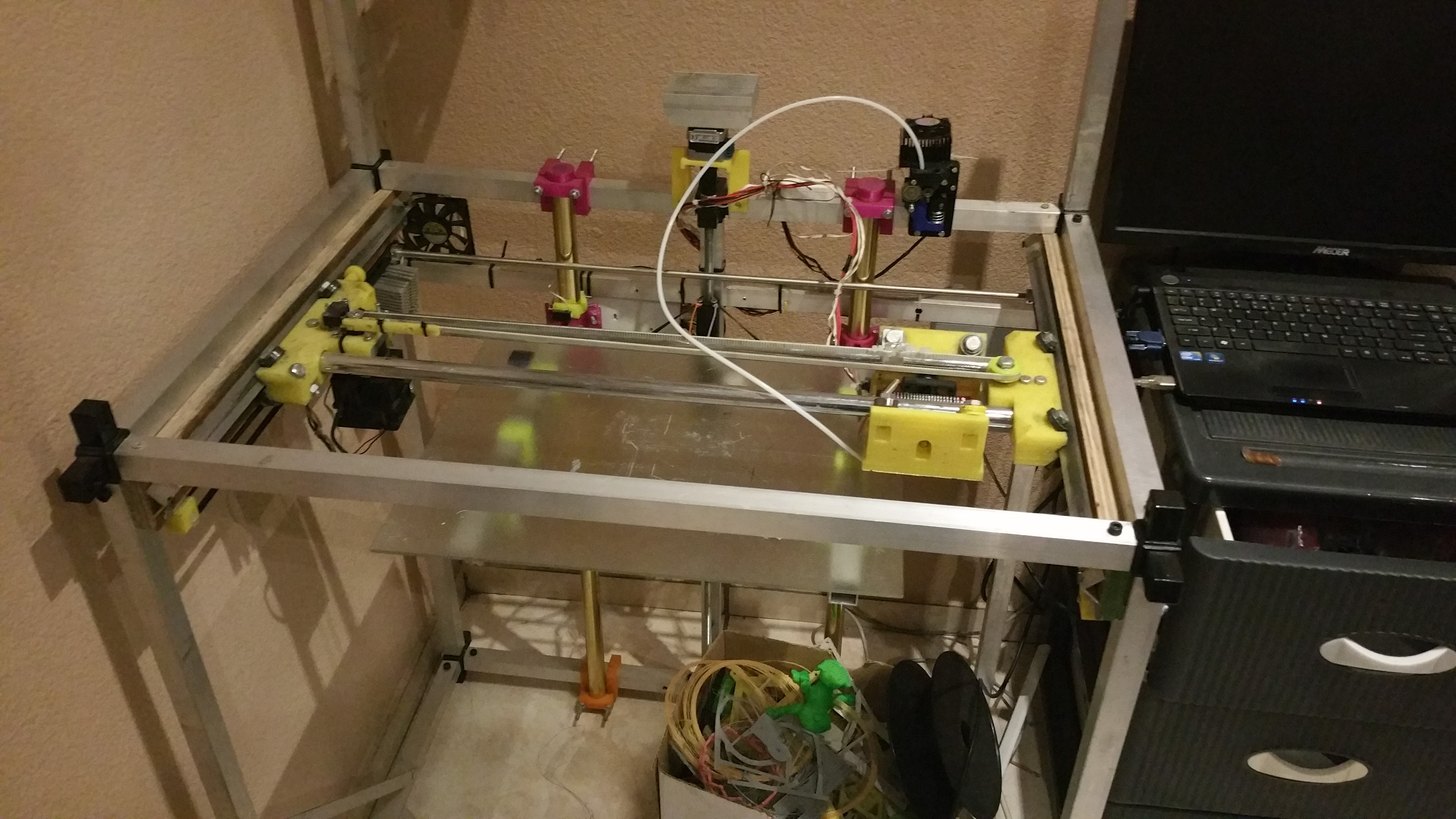

My history of printers. You will note my first printer was as strapped as a repstrap can get. And it’s 1st prints reflected that once I got it dialed in however 1st job was to print better parts for itself. To where the printer was printing parts that was really good. It was ably to print pulleys that held onto a t2 belt without slipping pictured in the one with the belt drive for the small steppers to cope with a heavy gantry. It then printed parts for the 2nd little printer mainly because I felt that if something broke on the big printer it would suck to have to go back to the wooden gantry parts to reprint a repair part. The little printer just performed like a champ it can print the nasa wrench over and over and they all work. Logically if that works bigger is better so need a big one and I upscaled the design for a bigger machine and then found it didn’t work as well. That would be the 4 gen on my printers after bracing it more it actually does print well but I wanted better. So the 5th Gen I redesigned the shortcomings of the 4th Gen built it and from the 1st print it just blew my expectations away. I actually printed a nasa wrench pictured before I calibrated the printer. It works but I had to change the steps on the one axiz by a fraction to get it right and the gantry wasn’t perfectly square so I had to adjust it. My journey is far from done but it was nice to get a compliment from someone that works with stratasys machines daily that I would not get the quality prints I have without spending what my house cost.

The belts are nearly silent the printed gears wore out and where noisy.

Pla doesn’t start deforming till way over 100’C if your motors are melting it you have too much current going through them. On the big machine I put heatsinks on them to keep them cool but since then I’ve started using bigger motors now and they are hardly warm to the touch. I printed velocity stacks for a car that sits on the intakes and they don’t melt. People say abs is stronger than Pla but it’s like stainless steel is harder than mild steel, they’re both bloody hard. I’ve printed Car parts that sit in cars and don’t melt ( and I live in South Africa it gets hot here) including a cellphone holder that sits on my steering column to keep a phone in line of sight for navigation apps.
