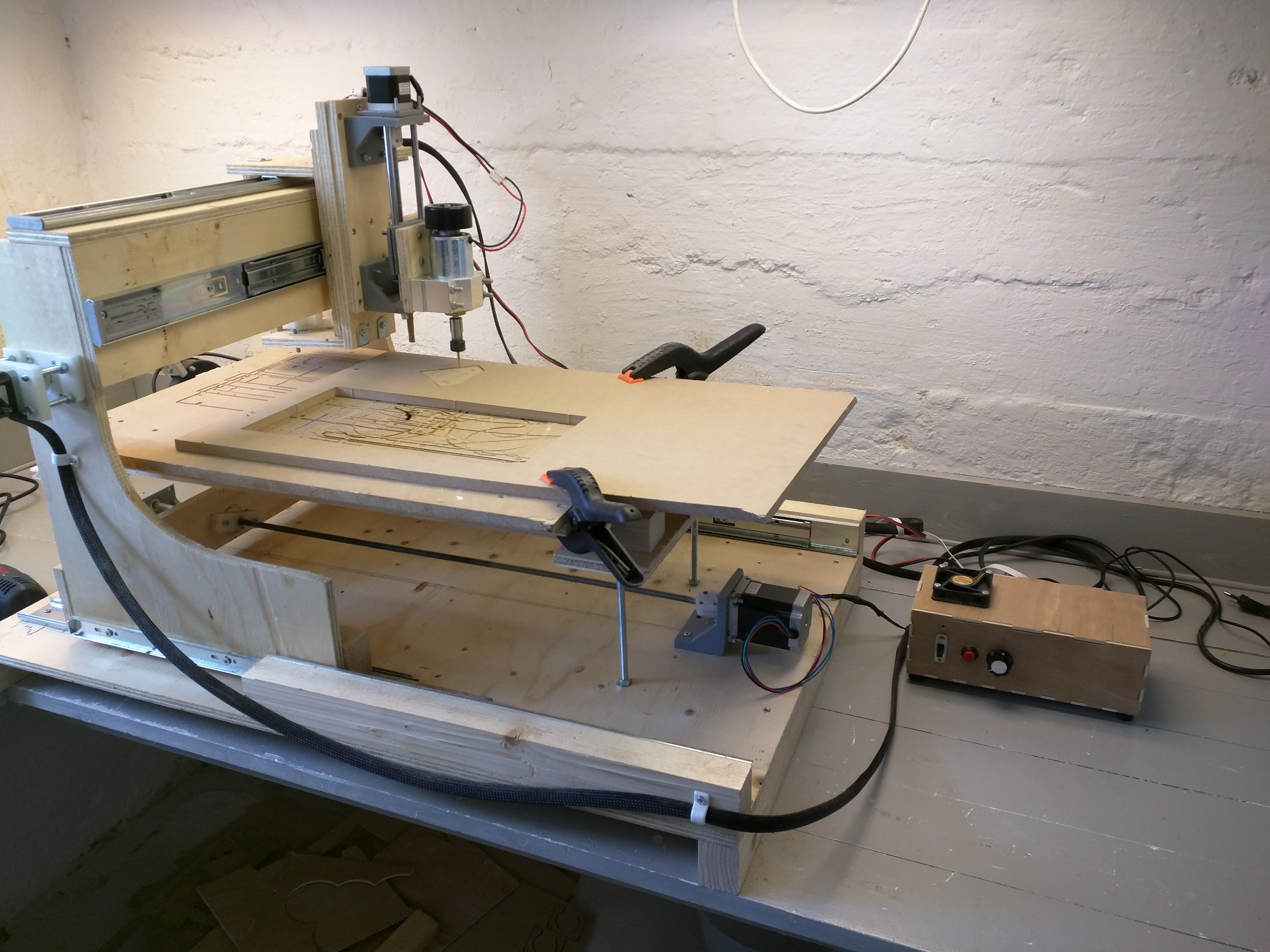

My homemade cnc running with no laptop
chilipeppr & raspberry pi… Unbelievably cool! Next step: mounting camera on the pi… And wait for the x-carve getting shipped next week
Cool machine. Just curious as to why you would’nt cut some OX plates and go that route vs an Xcarve
Thanks well I thought about it but it’s all about hours available… Time is a critical factor so I bought myself out of this one. But maybe I’ll build my next - even bigger - cnc
