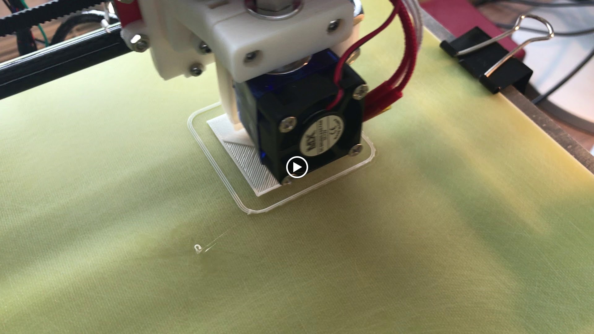

My hypercube works as designed, here a short video about the first testcube.
Awesome! Glad to see it’s working.
Hi Frank, what are you using as a printbed?
Looks like G10 board

The tip of the sensor looks awfully close to print. With that large heatblock so close to print you will have issue of curling when you print something overhang easy target for your sensor head to hit… But otherwise nice build :slight_smile:
@Petr_Cach hi, this is FR4. Base material for pcb‘s.

@Step_Cia the sensor has a high difference of 1mm to the noozle. Imho ok, but we will see :slight_smile:
