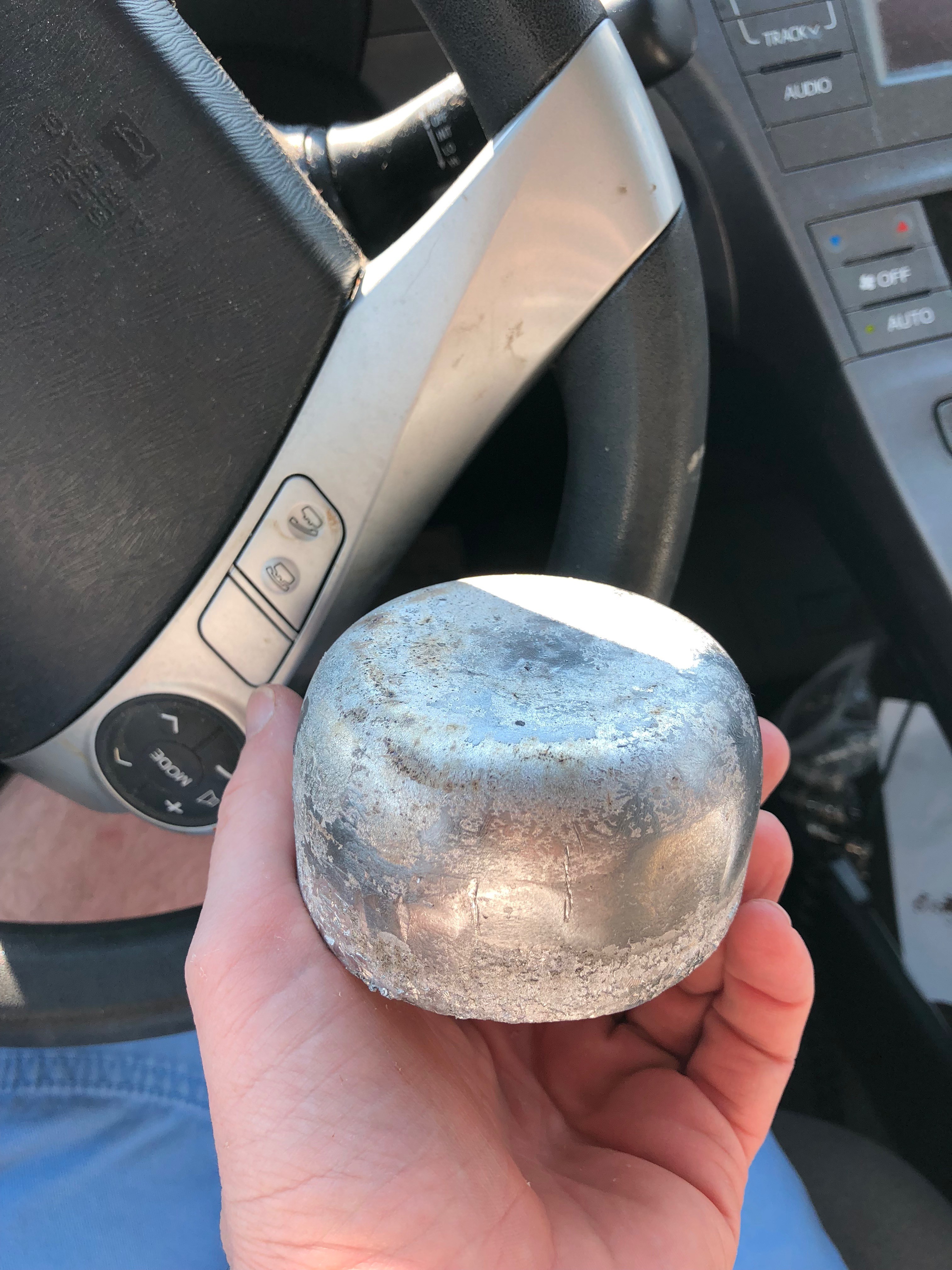

My in between project. I melted some aluminum.
Nice one! What is your Foundry setup like?
Looks like some nice Beercanium to me. There’s a slug of home smelted aluminum in my CNC machine. It is part of the bracket that holds my spindle. There wasn’t enough meat to tap in the extrusion I used so I epoxied in pieces I cut out of one of my muffin tin ingots.
@Barnaby_Relph it’s cheap. I initially made the one promoted on YouTube, that suggests you can make an effective one using charcoal…That was fruitless. I bought a burner off eBay and had to buy a different guage adapter that allows 25-30 psi and that thing is like a rocket engine. But, it still takes forever to melt the aluminum b/c I used plaster of Paris/sand mix. A better one would use cement, but I don’t use it that often. Mostly experimental work. I’m going to try to mill that into something useful. I don’t know if it was worth all the trouble.
