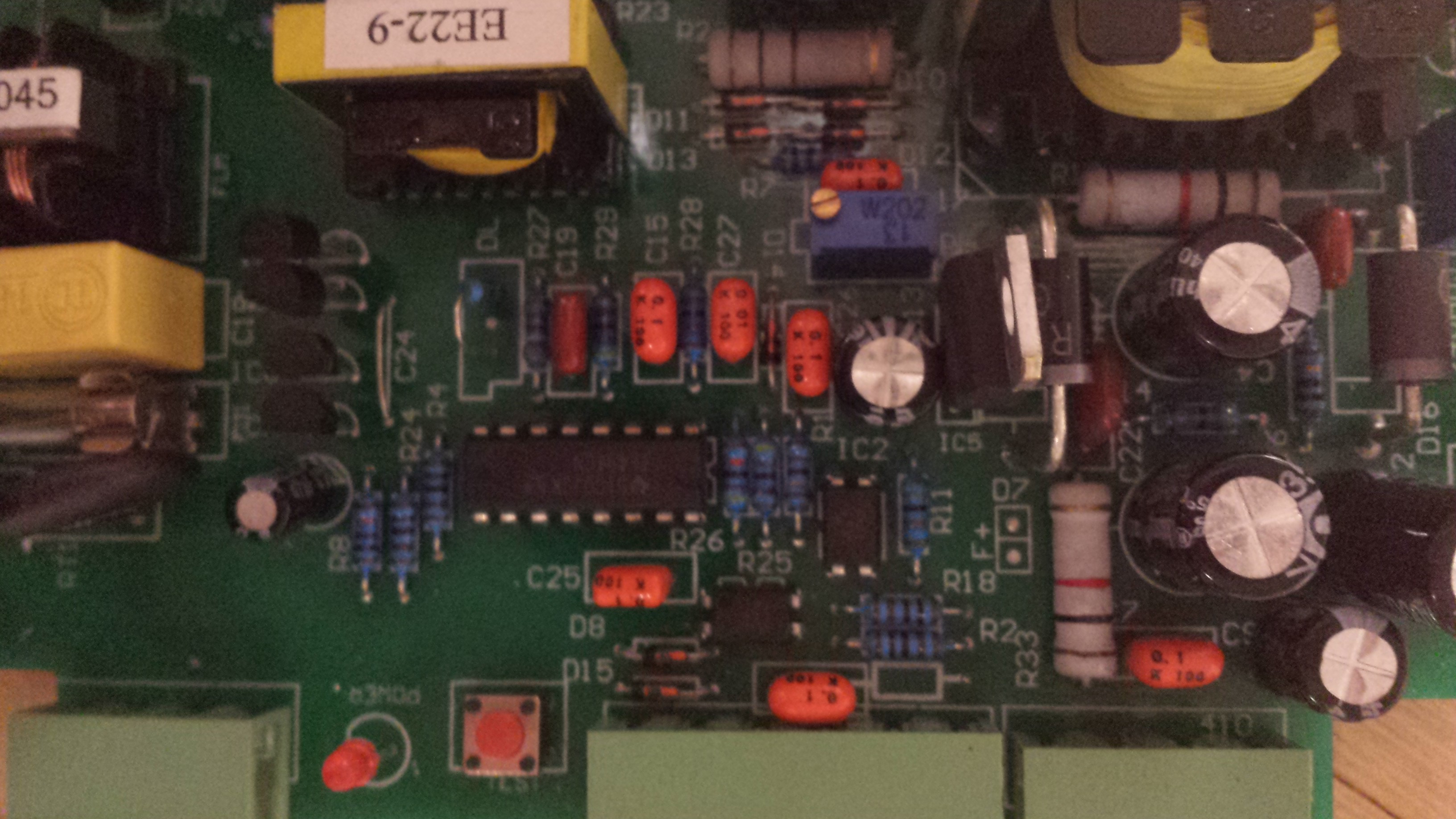

My k40 psu blew up when i pulled and pushed my usb cable into my laptop. Since i studied electronics at uni, i thought i should be able to fix that in a sec. The big schottky recovery diode next to the 12v regulator blew up (shortened) and the full bridge driver which are the 4 transitors in a row on the left(one npn transistor blew). I will draw up the schematic since the design has several flaws. The main one: No separation of the mains! So there is only one rectifier bridge between me and the mains. Opto couplers are implemented as barriers for the controls but all grounds have been connected to the minus of the rectifier, so these become superfluous of this flaw. No ‘snubber’ diodes on the driver bridge so soldered those in as well. My conclusion is that the designer took various power supply designs and cobbled it together without understanding of the electrical principles. Please be smart and add a seperation 1 to 1 transformer to protect your lives! After fixing the hissing is gone when I switch on the high voltage. I guess this was the leaking high voltage through my usb connection. The laptop was dead for 5mins and miraculously recovered, god thanks!

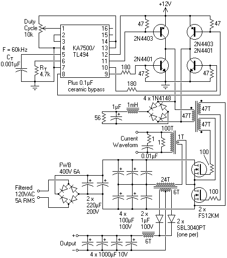

@donkjr repair is quiet simple since the design is very basic. The high voltage part should be isolated. I think that is easy to accomplish by removing the common ground. The high power psu is driven by a tl494 pwm chip which gets its 12v from the low voltage supply. Will publish that schema soon so it will show you the issues. Fairly easy to understand. Just google tl494 psu and you get the basic designs.
This is a very close similar design. Except for the ht transformer which is not rectified and its primary connection goes directly to the laser tube. The current wave form is fed back to the tl494 to regulate the voltage on the tube. This circuit does have the snubber diode on the bridge. Ours doesn’t. … further imagine the minus of the mosfet in the ht circuit is grounded to the rest. Ouch.

The schematic is interesting but I would guess not the same as the real one. The output caps on this are rated at 10V, the supply outputs many 10,000’s of volts :). I think our supply’s have a flyback and HV voltage multiplier but I have not seen the real schematic. Looking forward to yours.
@donkjr indeed this schema just show the principle of our k40 psu. None of the values applies of course. Hopefully i have some time this week to draw it up.
