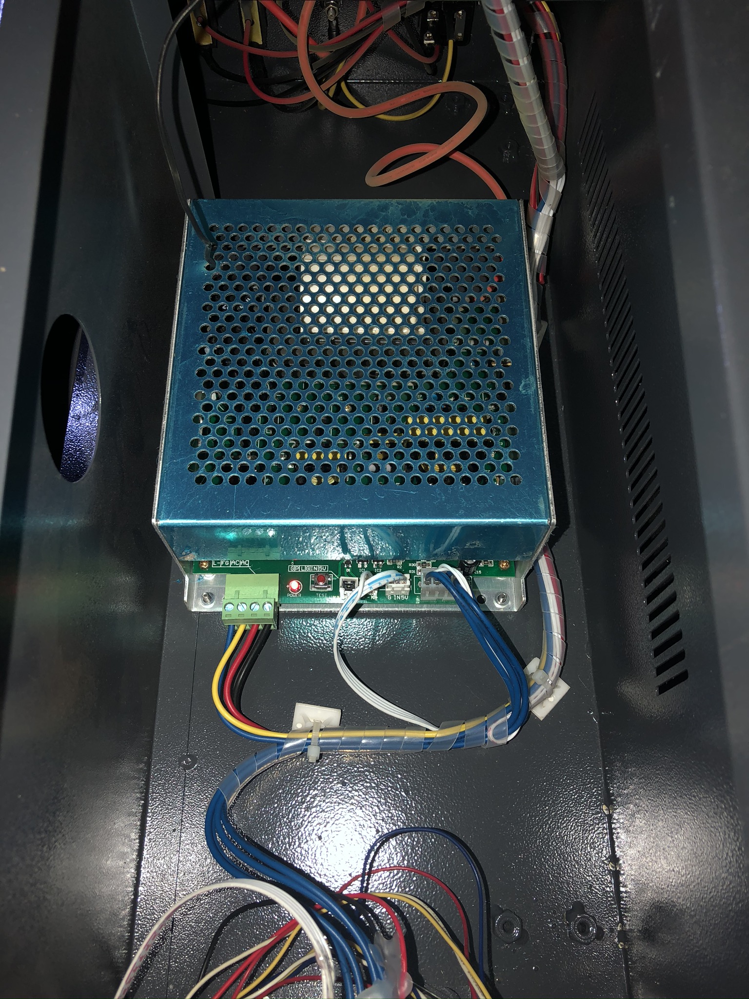

Post pictures of the control panel, LPS and controller on the failing one.

This the LPU from the “broken” one:
ps: what is the “test” button for?
The test button down on the LPS fires the laser independent of the state of the other control signals on the LPS interface.
