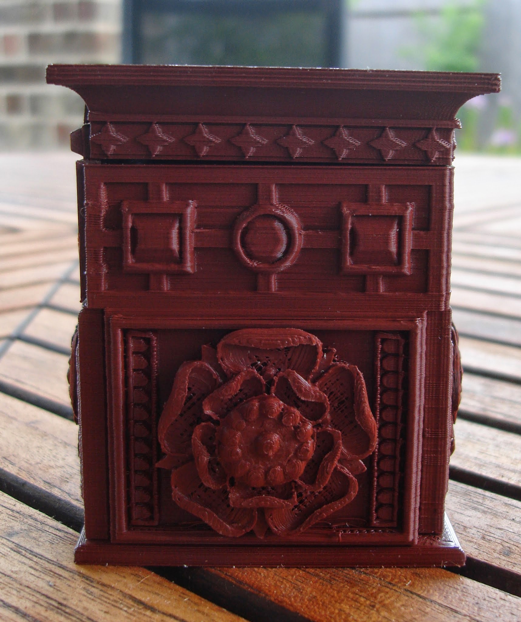

My latest design.  I call it the Tudor Rose box.  I have tried to
My latest design. I call it the Tudor Rose box. I have tried to create an effect of heavy wood carving that was popular during the Tudor period.
This was a real challenge.
This is 3D printed on my Ordbot using 1.75 PLA filament. Layer height is .2. Infill is 15%
The box also has a secret lock:-)
Beautiful! I think you achieved your goal!
Awesome! Can we get the STLs somewhere?
As a wood carver, I have to say I am impressed !
Brilliant! Abs-so-lutely brilliant.

What sort of finishing techniques have you used here, Louise?
Love the whole look of the piece. Truly original.
Sorry - what do you mean by finishing techniques? Something done to the model post printing?
Sorry, yes, I did mean exactly that, but now I’ve zoomed in and had a closer look at the pictures I can see that it’s the natural finish with layers still visible. I do like the choice of colour. I have a coffee-brown and a copper-brown but yours looks richer.
