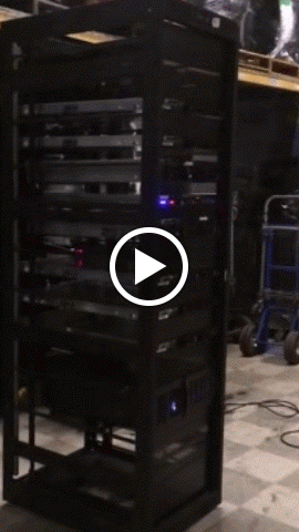

Lol @Michael_Sime i couldn’t remember who it was who was doing this, but i have made a video of real servers as promised.
You’ll notice that theres some big blobs of light, and they are all LCD displays. The majority of leds are green. Let me know if you want some more close ups etc.
Oops, video is currently private @Stuart_Taylor
@Stuart_Taylor - I’ve got plenty of examples of the real thing…my problem is coming up with a sketch that will do that!..
