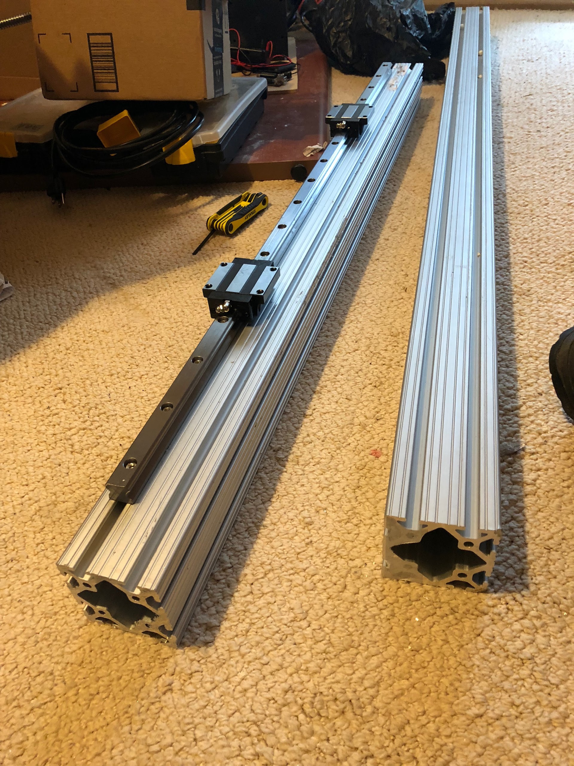

My main rails are now cut down to size.
Looks like a serious piece of kit!!
I hope so. I’ve been doing a lot of online research to get this together.
For anyone interested, a miter saw worked better for me than a chop saw (cut-off tool). Both of the ones I used were of the cheap (Harbor Freight variety), but their miter saw seems to have done the trick (though the clamp to hold the workpiece broke). But for a little over $100, I can’t complain.
@George_Allen What was the blade you used in the miter saw?
60T 10 inch (Admiral, I think) I’ll check to make sure. Regular/not for rip cut. Carbide tipped, I think
It was an Admiral Industrial 60T 10” crosscut blade with 5/8” kerfs
