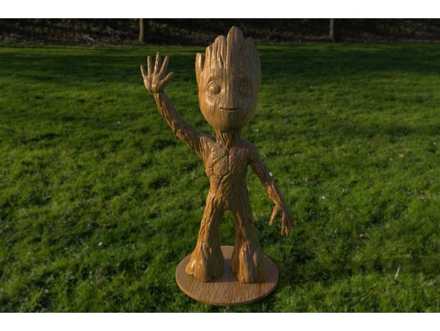

My new baby Groot! I overdid it on the supports a bit just make sure the hands came out good. Painted the eyes and green touches. Printed with wood filament…so ya know…it’s authentic. :wink:

Printer? speed? some data?

@Jakab_Gipsz printed on a Reliabuild3D RB2 (if you want specs, go to https://reliabuild3d.com/product/regular-basic/) 60mm/s print speed. 24% infill, .1mm layer height with a .4 mm nozzle. Wood filament from Hatchbox, calibrated to 1.65mm diameter at 215C.
