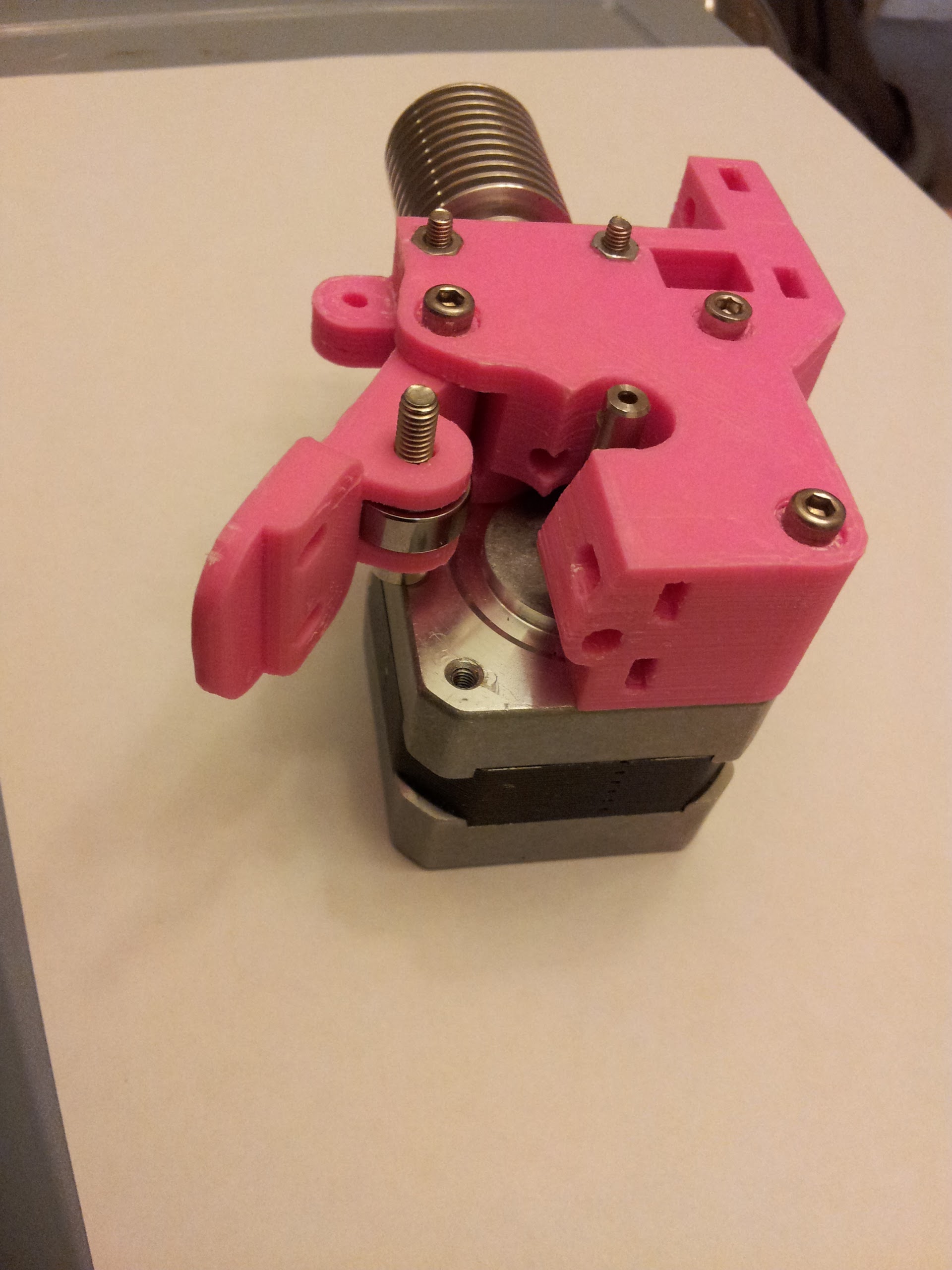

My new extruder, in the flesh (colored filament). For i3 rework, p3steel, and any design that uses the 4 screw mounting system.
Bonus points if you can spot the design flaw that I need to fix.
I see you got an E3Dv6 now?
My only concern is regarding clearance for the drive gear and/ or whether the idler bearing will contact it. Seems a bit tight in that region.
Only three holes to mount a four whole base?
The idler hinge needs room to move. 3 screws is enougt as the torsion is low.
I’ve had the e3dv6 for a few years now.
The design is specifically for a mk8 drive gear. Clearance is 1mm around the idler and drive gear. Ptfe tube goes all the way through. I need to drill the hole out so I can puse the tube all the way through.

The design flaw is actually a simple fix on a small part. The overall mechanics look good, the drive gear and idler will work.
You can see the flaw in the 2nd picture.

this looks to be very similar to the one I’ve been using for the last 8-9 months or so (http://www.thingiverse.com/thing:501755).
Overall it has worked well but some items I’d like to fix would be to drill out the body to allow for the ptfe tube to extend from the hotend up through the extruder body to near the MK8 gear. Right now it’ll typically take a few attempts to feed new filament in as it’ll catch on the edge of the ptfe tube and not enter the hotend.
I’m not using the 4th bolt to hold the extruder body to the carriage (top left) cause clearance is a PIA, and it hasn’t been a problem.
I would consider reducing the depth of the clamp that holds the hotend in place because right now it looks to be sitting flush. And what I’ve seen is that over time I lost some clamping power and the hotend can twist. No doubt due to me using PLA
Lastly, even though the idler arm is relatively solid, I’ve had filament sometimes slip to the side of the bearing depending on how it was feeding in. I’ve played with various springs to change the applied pressure, and in the end having super tension didn’t seem to matter.

Tim, my design has the ptfe go through by default. I losely modeled it after the design you linked.
The clamp can be sanded or filed to exert more pressure, also dont use PLA for extruders.
Surprised nobody caught the flaw yet. The screws on the clamp interfere with the screw for the fan mount. If I were to add a fan, it would not fit.
This style clamp is tricky the get the ptfe tube in. You need to feed the tube all the way through, lock it, then trim it. The other option is to trim the top of the tube just before it enters the hotend, then butt up another piece to is. That way you can remove the hotend without need to completely disassemble it. That is because putting in the tube and cutting it is easy, but pulling it out would be difficult and likely damage it.

Yeah, I know we shouldn’t use PLA for the extruder body, but I didn’t have anything else at the time. There’s no doubt that the feeding in of the tube and clamping the hotend into place is a pain when having to take apart. Right now I have it just butted up so as a result you have to be sure and feed some filament into place before tightening so as to ensure alignment.

I just updated the extruder to v2b, fixed the supports, fixed the fan mount on the clamp. Now (whenever I get around to designing the fans) the fan mount will be clear of the screws. this also makes the fan mounts the same distance from the hotend, meaning that fans will be interchangeable on either mount.
It does use a M4 button head screw, however you can probably file down a socket cap just a little bit so it will fit (~0.5mm).

@Tim_Sills PLA extruders had more potential to melt when they were the original Wades. The Rework Wades don’t seem to absorb the heat in the same way. I’ve got a couple of years and hundreds of hours on several PLA extruders used up to the limits of the v6 Lite or about 245*. I’ve got a Bondtech on the high temp machine. I don’t know I’d run the PLA extruders for the higher temp plastics.
I also tested a variant of that Wilson design (I’ve been using it for about 8 months) with a full PTFE tube. I haven’t needed it but look at how Bondtech has the hot end mount to allow easier installation of the hot end with the tube. He basically grooves only one side of the mount and that makes it easier to slide the hot end with the tube installed into the extruder body.
@dstevens_lv , yes, I agree in that my PLA extruder has held up fine for all of the printing I’ve done (even PET @ 240). With the E3DV6, there’s obviously not much heat creep. But, I did notice over time how the hotend was twisting and had come loose. And I think it’s due to the clamp having slightly softened and stretched a tiny amount (like less than a mm). But fully tightening it no longer cinches down the hotend. I ended up putting a small piece of filament in between the clamp and hotend as a holdover till I figure out what I’ll do next…try Stephanie’s or move to a dual head setup.
