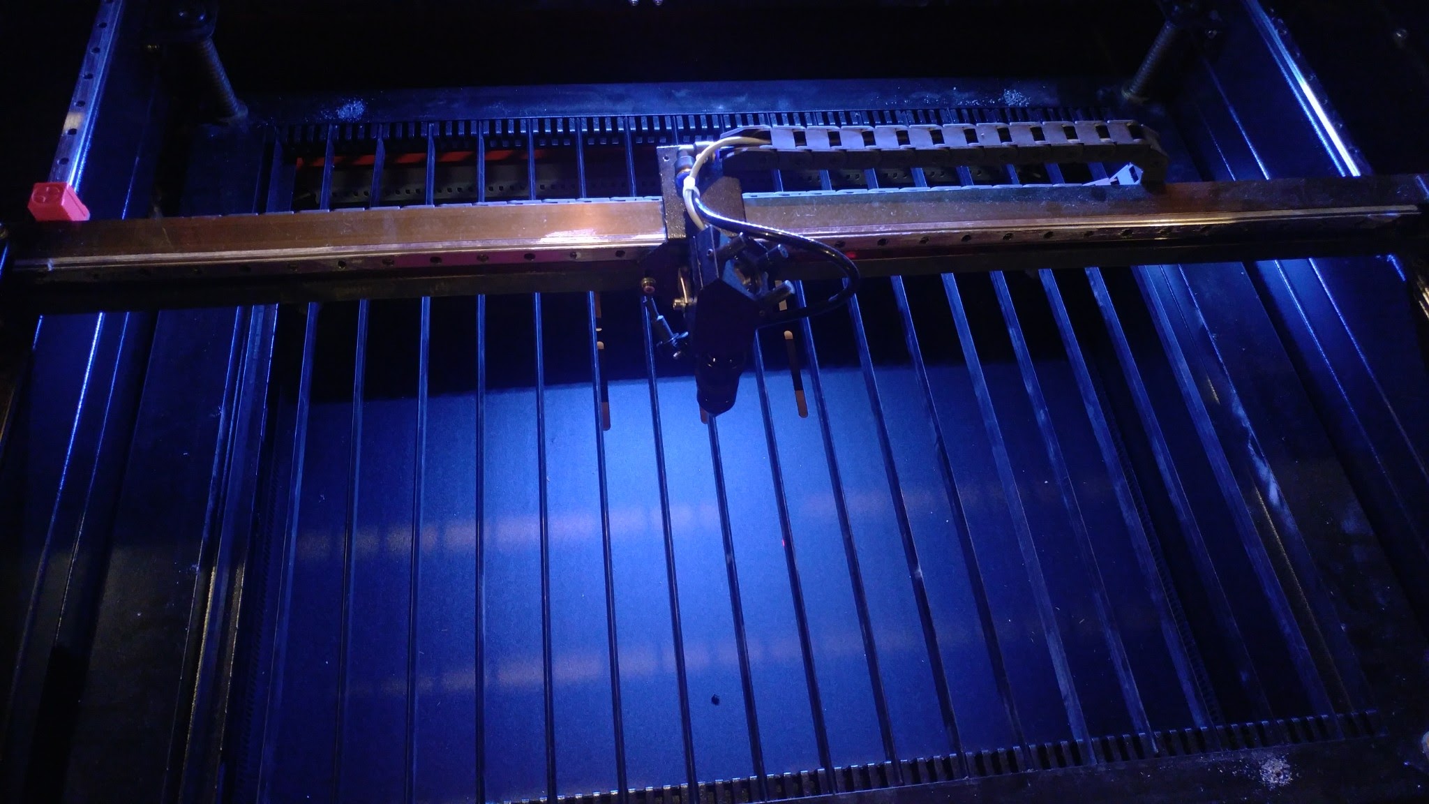

Been working on alignment etc… Noticed the bed underneath the honeycomb…
Removed the honeycomb which was held in place by 4 tapped screws and there’s an adjustable blade bed underneath.
The fan isn’t great. It is 110 volt with a Chinese plug. Travel adapter got it working and it shifts a lot of air. The empellor housing however isn’t sealed so there is air blown out from the body of the fan and not just out the ducting.
So any input on when to use blades versus honeycomb?
Also there’s no interlocks despite being advertised as having them.
Use blade bed if material you are cutting is stiff,ie mdf ad use honeycomb for paper
