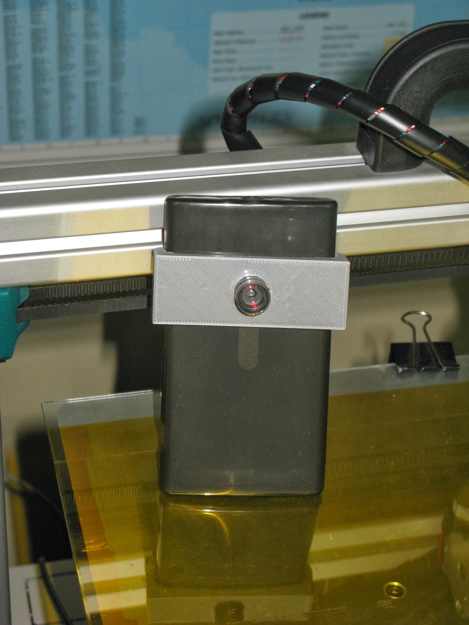

My new Nokia Microscope.  Well sort of.
My new Nokia Microscope. Well sort of. It’s the lens from a flat bed scanner
You just stuck it on the bottom of your phone? Can this be done with any scanner lens?
@Nuker_Bot_NukerBot_3 I’ve gotten pretty good results with the lenses from DVD-RW drives too if you have an old one around. Can’t say for sure if the magnification is the same.
Great thanks @korpx . I have a ton of them around.
Yep, just stick it on the end of the phone camera. It can be a a bit hard to focus and you have to use an external light source. Actually taking photos can be a bit tricky as you have to disable the flash and hold the camera very still.
One enhancement would be to have something to hold the camera a set distance from the object at the right focal length.
I have an old Sony handcam that I’m thinking of pulling apart. It has a good lens with a great voom…
I can 3d print a stand for my phone.
