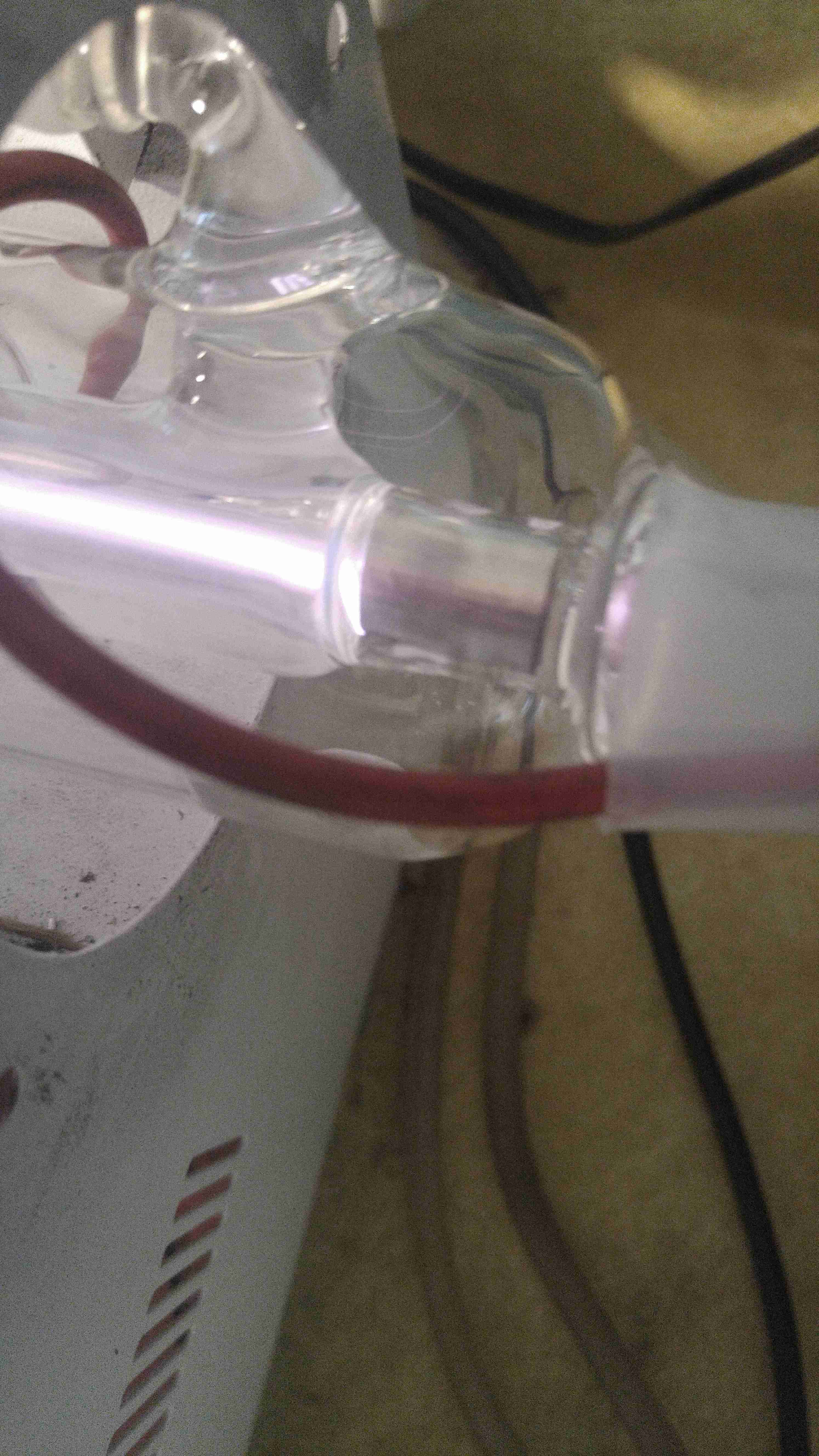

I was considering putting the old tube back in, but had an accident with it that caused the glass to break at the cathode terminal/post.

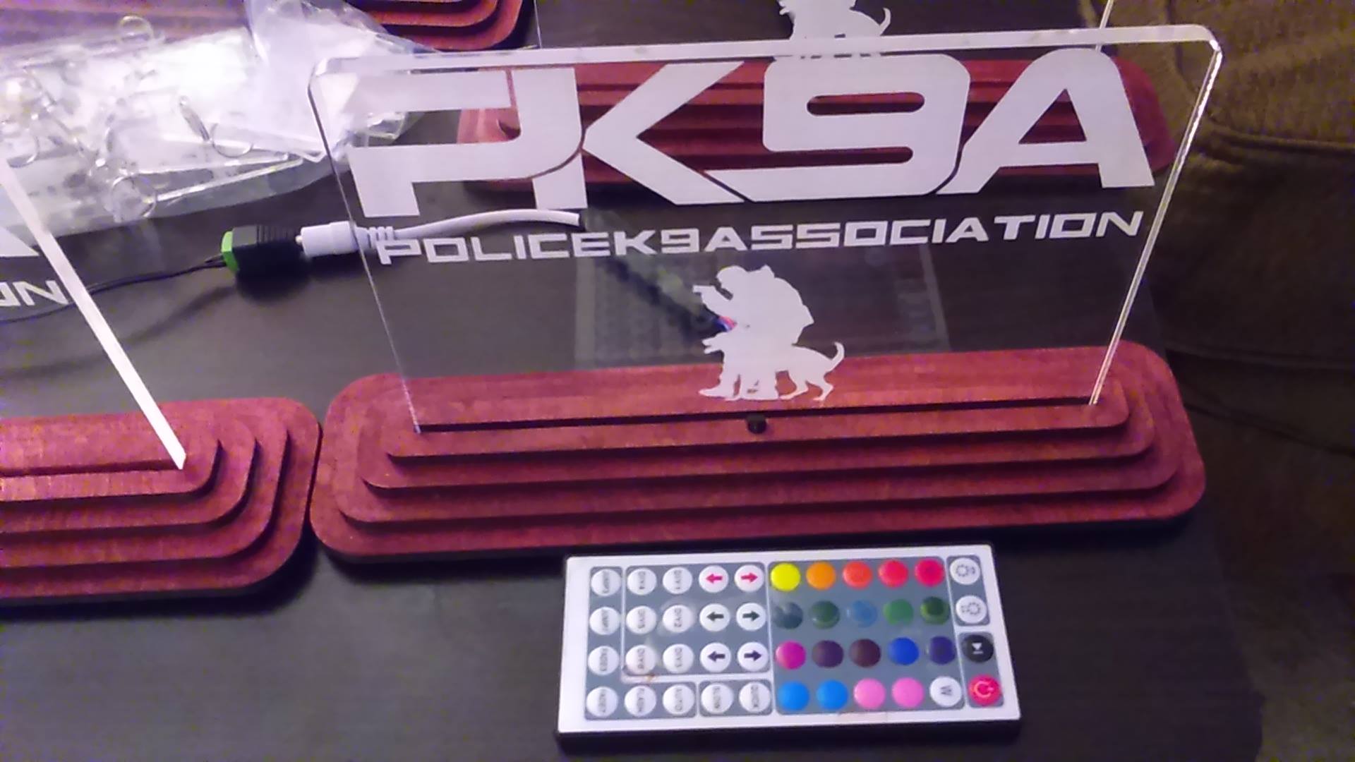

It made a fizzing noise that low, but I actually liked the way it worked, the texture it gave on acrylic while fizzing. These were done around 3-4mA withe the old tube while still fizzing.
