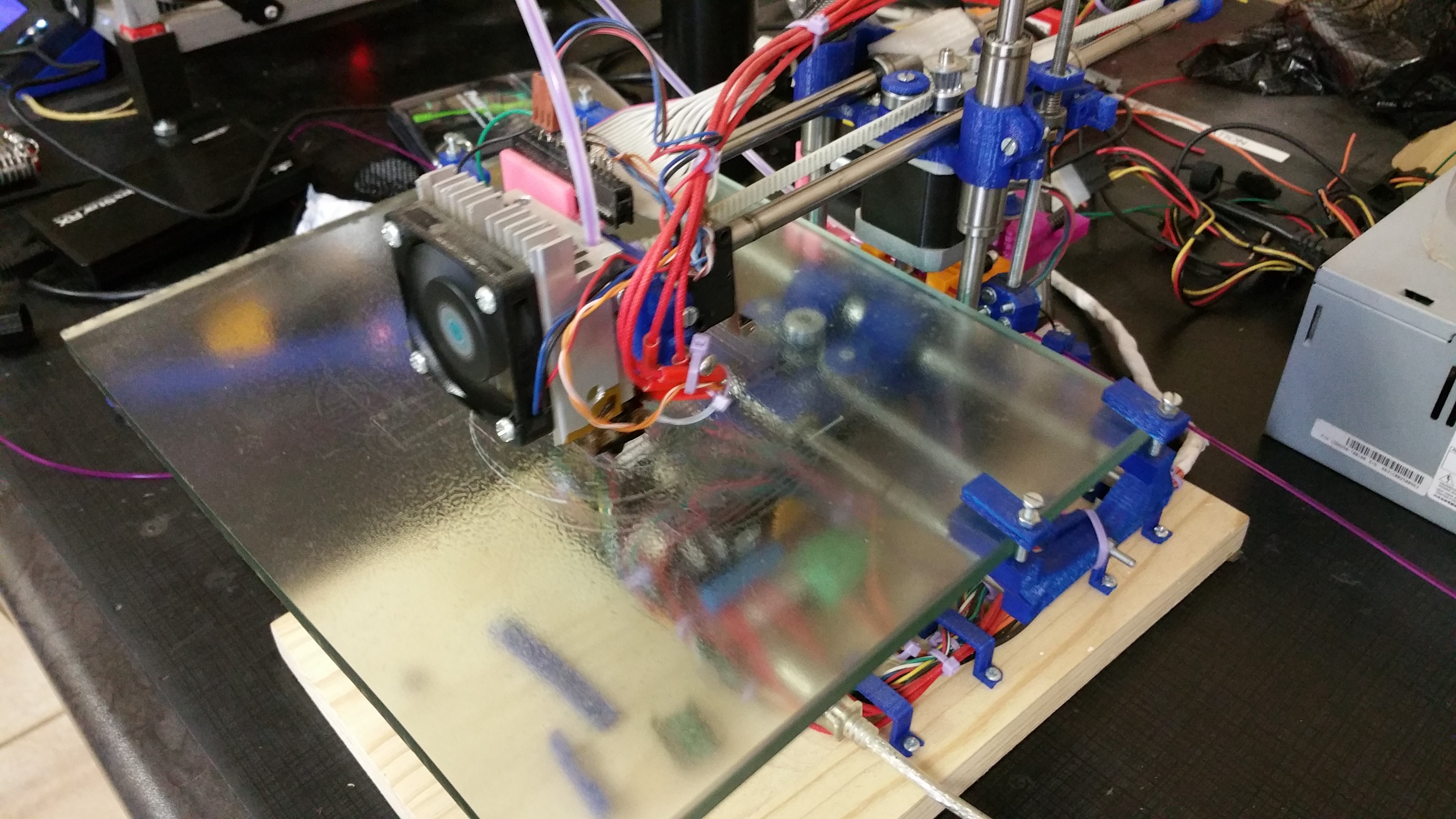

My other printers are actually printing for a paying job so I dusted of
My other printers are actually printing for a paying job so I dusted of the smartrap sent it some G code and off it goes… it’s such a nice printer but it’s does have a few short comings. I’m really torn between trying to sort it and using the parts for a printer similar to my P3 that was also a smart rap before.
I’m so cut on mine as well. I like the simplicity but I see flaws that I don’t see getting worked out soon. I just switched to inductive leveling as the endstop leveling was the biggest problem with mine so we will see if it improves from that.

If you look at mine you’ll see I canned the auto leveling and modified it to manual levelling I haven’t had to level it in a long time.
